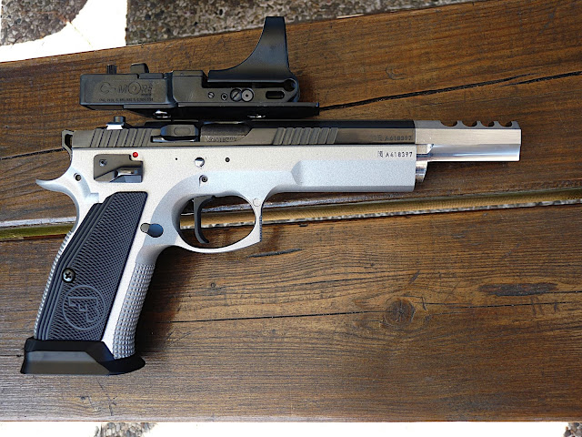

Mattias from BEnos:
Dennis from Global Village:
Both are TS's, and both are being built by their respective owners as one-offs.  Mattias is doing an extended barrel + homemade comp.  Dennis appears to have cut the front of his TS, and made it like a 1911 (though I don't know the specifics yet).

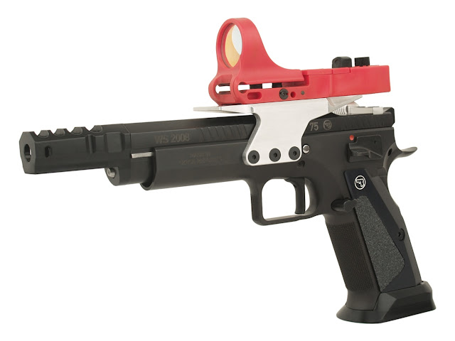

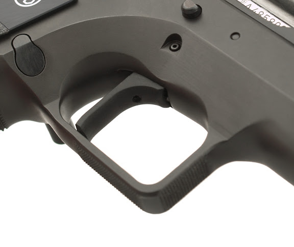

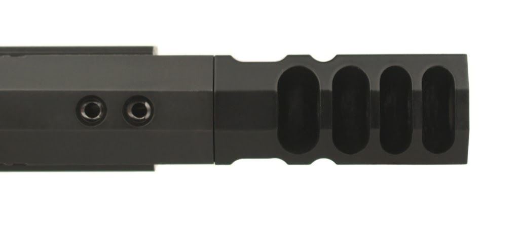

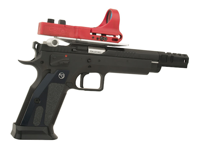

I've yet to hear any confirmation from US CZ peeps, but some CZ guys over in Europe confirmed to me that CZ is going to be producing a factory open gun, sometime in the near future.  Looks to be based off the TS platform, though with most of the changes that you see people doing with TS's already done.  As the word goes, CZ might be selling retrofit conversions for existing TS's.  Take all this with a grain of salt though, cause who knows what the final deal will be.  These are the pics I've seen, which I've seen since posted in several places:
