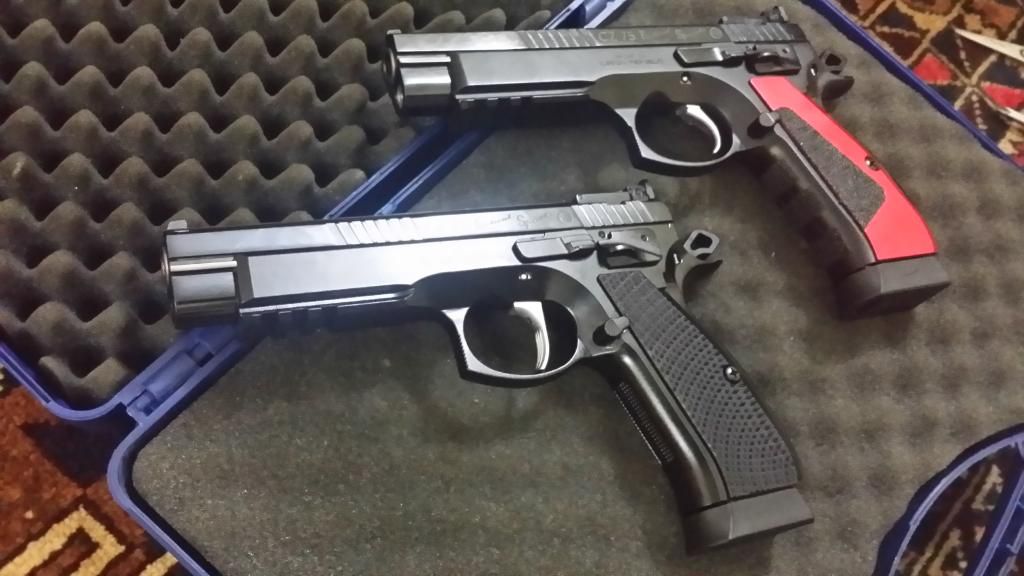

« Reply #15 on: March 02, 2015, 11:16:34 PM »
And above all, these look awesome...specially in pairs.

Re: What Good is a Tactical Sport in 9mm
« Reply #16 on: March 03, 2015, 12:06:55 AM »
I'm jealous. *drooling*
CZ75 SP-01 Tactical Custom 9mm
MP 9mm 2.0
Glock 19
« Reply #17 on: March 03, 2015, 12:10:52 AM »
A fine pair indeed.
