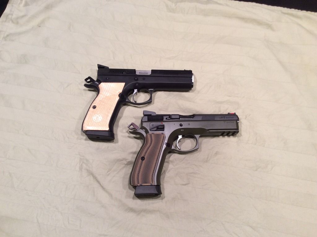

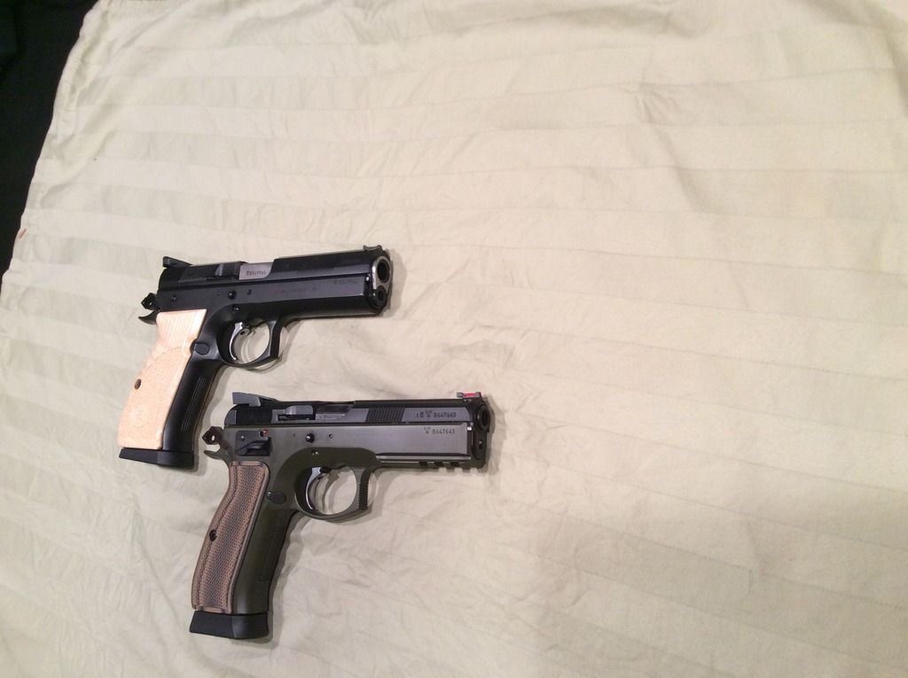

Here we have 2 fine pieces of work done by Schmeky, aka the CZ whisperer.  Thanks David!
Unfortunately I am having issues with coated swc 200 gr acme bullets in the 97.  I was using 4.6gr bullseye powder.  I used a Lyman case gauge for my 'ok' check but it appears the chamber is tighter than the case gauge.  Three bullets I had issues feeding I measured.  Base- 0.471-0.472, Crimp- 0.469-0.470, OAL- 1.251-1.255, Base to shoulder- 0.933-0.936.
When I had the barrel out of the gun, I dropped the bullets in, 2 fit snugly and one I couldn't even push in.  It seems the base of the case is too fat.
Anyone else have issues with swc's in the 97?  Will a factory crimp die help with this?  I tried to shoot 100 rounds, 75% had feeding issues...  :-[
