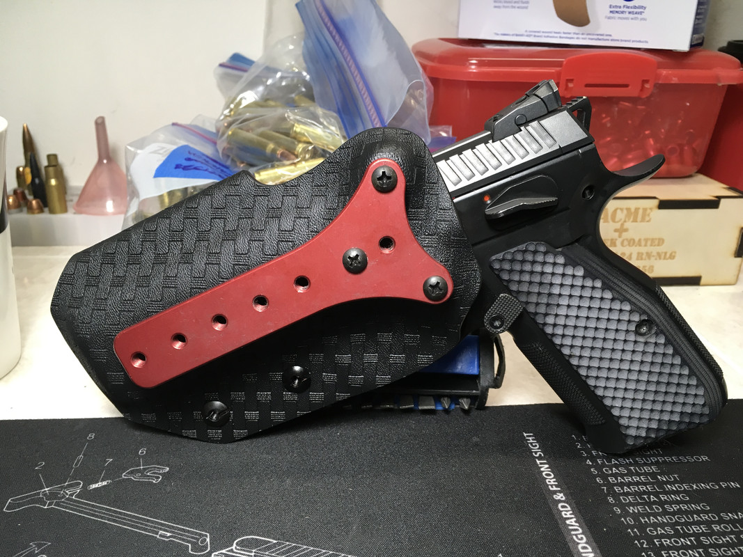

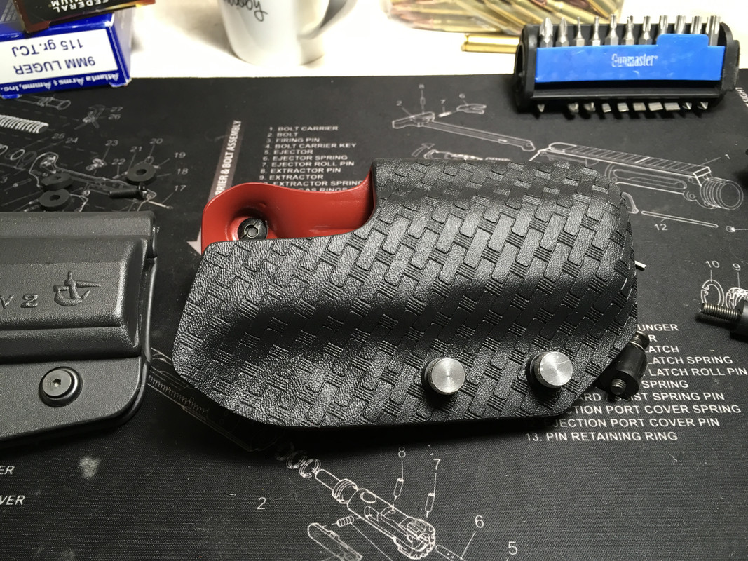

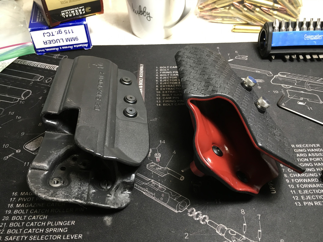

I have a comptac holster. I had problems with the mag release being inadvertently pressed during my draw and cost me some time during a match. When it?s pressed a little bit, it unlatched the mag but doesn?t drop it so I can Fire the first shot but no round goes into the chamber afterwards.
I ordered a new kydex holster from Brendan (Iksyotas from Brian Enos forum) and I used it at last weekends match. It was way better than my old Comptac holster. Draw was more consistent and smoother. Best of all, no more accidental mag release operation.
Here are some pictures. I also posted them in the holster subforum.
Old comptac and new holster. The comptac was single layer while the new one is double layered.
The new holster doesn?t cover the mag release like the comptac does. Since it?s covered on the comptac, that?s when I accidentally pressed the mag release against it during my draw.
