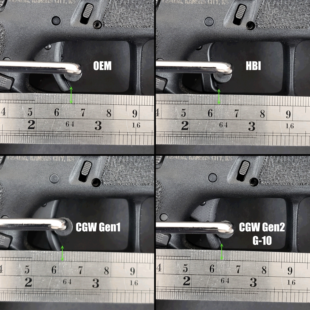

« Reply #7 on: July 30, 2019, 08:55:20 AM »
I prefer the CGW trigger shape.  It’s close to OEM which is nice because I pull closer the the first joint of my finger.  The flatter cross section of the HBi makes it feel like a longer reach, better if you oull with the pad/tip of your finger in my opinion.
I never had problems with the mag release pin or tblock so I only got the trigger shoe and striker.
The aluminum trigger is smoother but after a few mags it can get hot unlike the G10.  I lightly wet sanded the sides of the G10 with 3000-grit to slick it up.

Thank you for the input and the illustration. I ended up ordering the aluminum one from cajun because the G10 was out of stock, unless I wanted the orange and black. So I am going to run this for now and once the G10 is back in stock Ill buy that for my P10C. Thanks again for your input much appreciated
