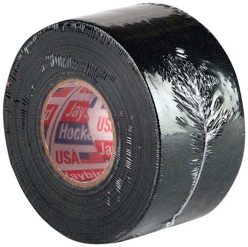

« Reply #6 on: April 07, 2015, 05:19:21 PM »
I'll probably try the foam insulation, does it let your stock close without putting stress on the folding pin?
Take the pipe insulation and cut out a lengthwise piece of about 120 degrees of the circle, making the foam instead into a "C" shape.  Position the open "C" end on the side of the folder that meets the receiver and wrap it.  That way you can use whatever thickness of insulation and wrap it as tightly or loosely as you like and it will still fold easily.  I wrapped mine first with black med tape to hold it in place, then a moderate tightness of paracord for durability.  Since it's staying on, I also lightly oiled the stock in case of moisture seeping, but that's probably overkill.
