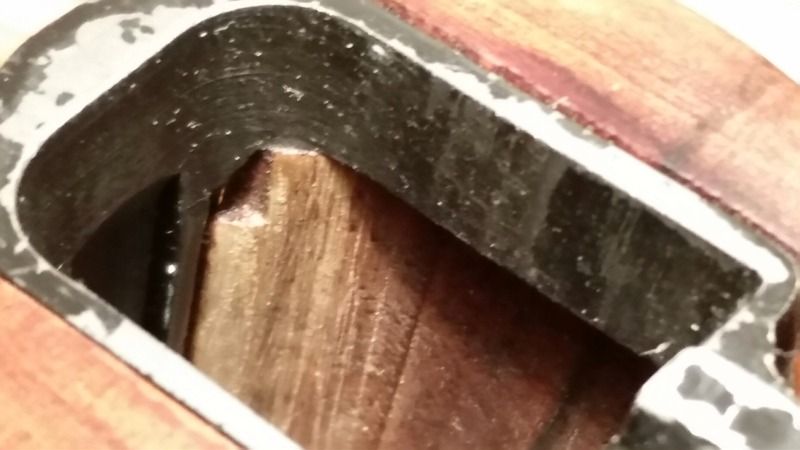

Had some time to finally look at my 82. What I found was the the mag release was gummy and the aftermarket wood grips were hitting the new mags. I was going to disassemble the mag release but blowing it out with cleaner, pressurized air, and adding a drop of lube was all it needed to easily depress and get comlete action of the release. The new mags seemed to be hanging up on my aftermarket wood grips but not the factory plastic. A little sanding fixed that. While I had the grips off I used some 1500 grit paper to polish the inside of the mag well where the mags rub. Hit the front and back of the mags while I was at it. Nothing serious, just looks like they have been used for awhile. Now the mags drop free with the slide closed and open like they are suppose to.
Might get to the range tomorrow and see how they feed.
