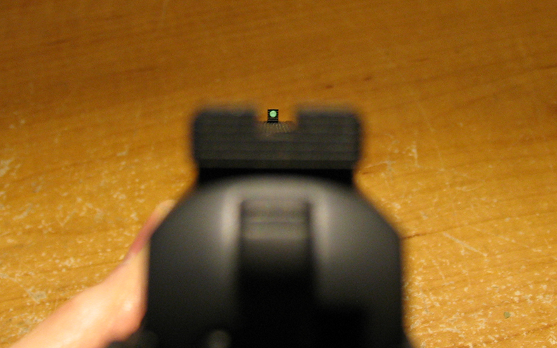

I got it! ;D That was really on there.
I couldn't resist going downstairs one more time after a beer with the sledge hammer. Of course I got it this time because my pusher's arriving tomorrow. >:(  This time I took-out the vice padding and used some rubber magnet material instead. Some HEAVY wacks and it started moving. Even when the sight was almost all the way off, it was still harder than my PCR to remove that sight from scratch.

Thanks. No corrosion. Some of the polycoat stuck or rubbed off onto the sight (#4) and the slide's dovetail shows bare metal in spots - the sides, not the bottom. Should I cover the bare metal or just oil before the new sight?
I don't know if it's out of spec. I can't measure the width of the slide dovetail at the widest point but the factory sight is is .375" - .376" on the widest point. The dovetail opening is .323".  The dovetail depth is hard to measure with the protruding stick of the calipers... I'm getting .108" -.108.5".

Thanks. My new sights are in. I measured with a calipers and got it dead center with the pusher. I won't loctite until I get to the range. I did clean with alcohol and blued the exposed metal. I also used a toothpick to blue the end of the front sight pin <--OCD!! The pusher worked good. I put some small pieces of rubber magnet material on the inside of the metal pusher to protect the new sight. I even took my PCR out and centered it better.
I file the back angle and not the bottom- of the sight ...just a matter of preference I guess. With the front sight I sanded the bottom in addition to filing the sides very carefully with the needle file. The front sight I used (link below) for my P-01 and PCR needs a lot of fitting. I learned from last time, when I only sanded the bottom of my front sight to get it to fit, the half moon cutout for the pin got too shallow and I barely got the pin in. Also the front sight was too low and crashed into my anti glare serrations on the top of the slide. This time, no issues. Thanks again.
