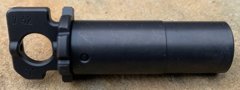

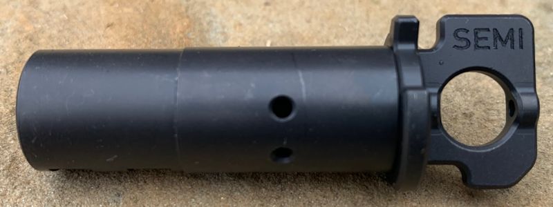

Here's the new gas valve.  There are three holes instead of two like the old gas valve.  The "normal" one is visually smaller than the normal one on the old valve.  Unfortunately, all of the holes are larger than my rod set.  All I can really say for sure is that all are greater than 0.060".  I did use calipers to compare the two normal size holes.  Obviously the measurement wouldn't be accurate, but I can say that the new gas valve normal hole is about 0.015" smaller than the old gas valve normal hole.

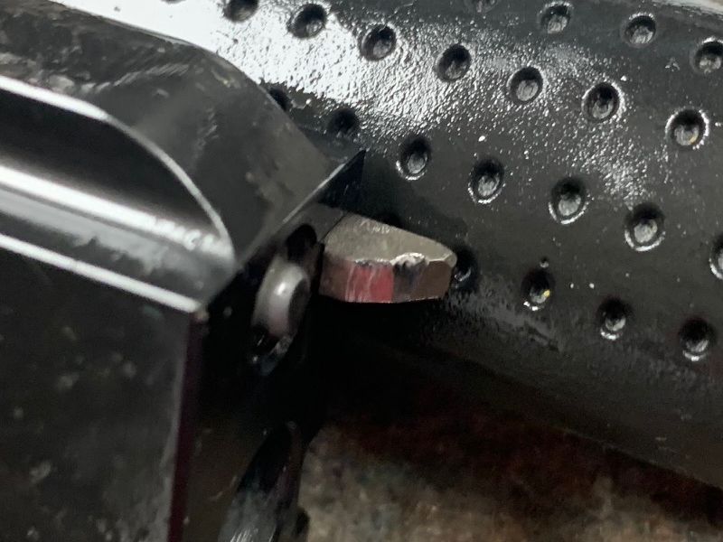

I disassembled the extractor from the bolt in order to see if there was any debris.  It was actually pretty clean in there, but the piece of rubber or whatever it is inside the extractor spring seems to be bulging out so much that portions of it are mashing out between the spring coils.  I actually cut a bit off because it was coming through so much.  I noticed a burr on another part that I don't know what it's for or what could have caused it.  It's shown in the final picture.  Any idea what that's about?
Interesting! My 11” x39 Bren has not had any function issues (knock on wood), but I don’t dare disassemble the extractor lest I break or lose any of the parts, which of course, the spares are non-existent from CZ. If it ain’t broke, don’t fix it, so my gun sits collecting dust, awaiting access to spare parts.

I received my pin gauge set and measured the holes in the gas valves.  The results are below.
Old gas valve:
Normal = 0.075"
Adverse = 0.097"
New gas valve:
Normal = 0.063"
Adverse 1 = 0.071"
Adverse 2 = 0.087"
Unfortunately, I can't try it next weekend, but I will as soon as I can using the same ammunition I used before.
Old gas valve:
Normal = 0.075"
Adverse = 0.097"
New gas valve:
Normal = 0.063"
Adverse 1 = 0.071"
Adverse 2 = 0.087"
Awesome! Thanks for posting that! Let us know how it shoots when you get a chance.
I got the same measured results on my original 2 position gas tube (we both have 11” bbl. 7.62x39 Brens).
Good to see that CZ is finally addressing the over-gassing issue and is narrowing the gas ports accordingly. Hope CZ starts making this revised 3 position gas tube available to all of us soon.
Still would be good to know what size hole HBI is drilling their 3rd position gas port to, by comparison, so if anyone has that info, please post it.
