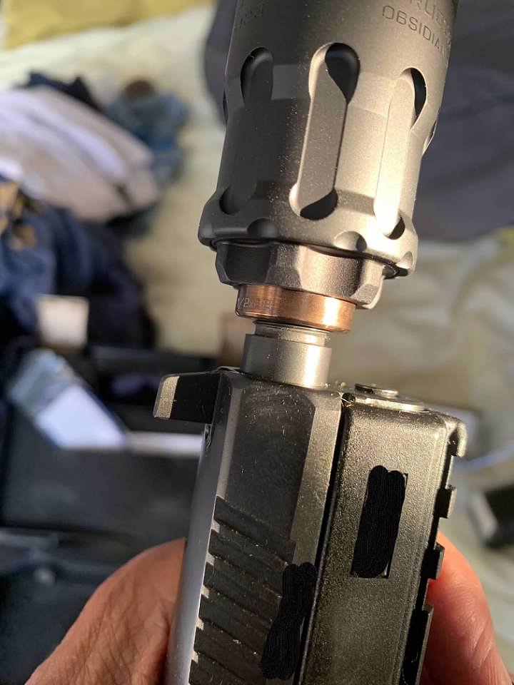

Finally picked up a 9mm suppressor, couldn't help myself with the short wait times (less than a week in my case), but ran into a glitch. Suppressor won't seat against the barrel shoulder, which is a no-go for the time being. Not crooked, but just not seated flush against the barrel shoulder, by about 1/8 in...
Anyone else have this problem with a Rugged suppressor mounted to a CZ threaded 9mm barrel?
It does seat properly on my M&P FPC carbine, so it’s apparently not the suppressor.

No issues with my P10c and an obsidian 9.  Will measure the tread length later today.  (For some reason Tapatalk will not let me log in so can’t post any pics).

Depending on the firearm, it's not uncommon for some suppressors to fit next to the shoulder and on other firearms not reach the shoulder.
Use a jam nut preferably or a crush washer and it should be fine.
