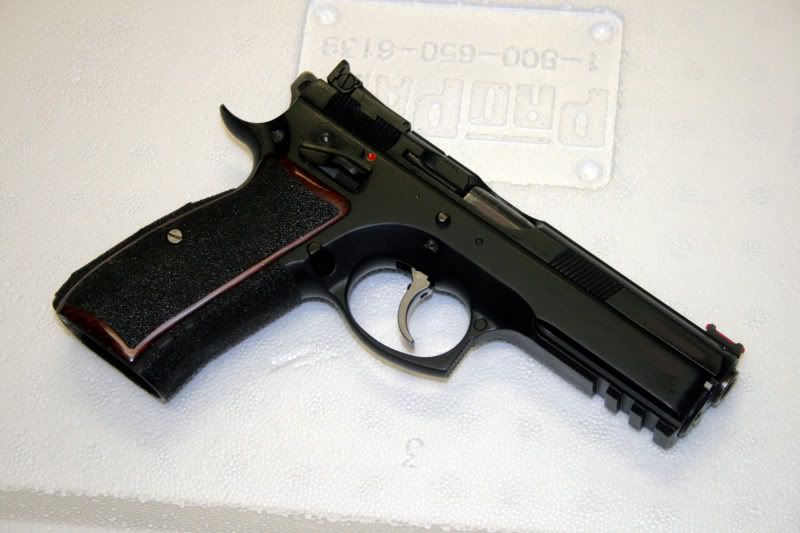

Offline double pedro
  • Posts: 391
Re: Who knows TS rear dovetail dimensions?
« Reply #12 on: December 12, 2008, 08:09:39 AM »
Here's a Champion sight I installed that I got from Angus.
