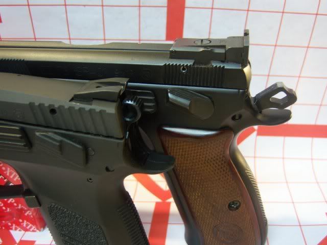

Hi everyone!
After I bought my P-07 duty I can't push the safety up to the Safety-On position when hammer is down.
http://content20-foto.inbox.lv/albums133825073/gatinsh1984/CZ-75-P-07-duty/Pic1.jpg
I can push the safety up to the Safety-On position only when I a little bit move hammer backwards.
http://content20-foto.inbox.lv/albums133825079/gatinsh1984/CZ-75-P-07-duty/Pic2.jpg
http://content20-foto.inbox.lv/albums133825084/gatinsh1984/CZ-75-P-07-duty/Pic3.jpg
What's wrong???

Nothing. The safety only works when the hammer is cocked.

The safety works when the hammer is not cocked. ;)
Some posts from December 2009.  See the picture.
For all you gun nuts out there who are enjoying your nifty PO-7 Duty guns, are you able to flip the safety to "On" without the hammer being cocked? I ask only because my 75B (.40) does not allow me to engage the safety unless the hammer is cocked.  Thanks!

I never tried it with my P07 when I had the safety installed, switched to decocker. 99% of CZs require the hammer to be cocked for the safety to be used, a military requirement.
YES,  only  Duty can do it.  SP-01 and 75B need to be cocked to engage the safety.
There ya go, I wasn't looking forward to re installing the saety to try that, thanks, excheck.
10-4, excheck.  You da man!  A picture is worth a ... oh, wait!  You've already heard that one.  :D
Amistad

mine only works when the hammer is in the 1/2 cocked position and at full cock...
Yours doesn't look like it's 1/2 cocked though in the picture... that's odd.

I bought my first DUTY from Angus and he did trigger job before the shipment.   CZUSA  replaced it with the new one (sticky mags) and  did the trigger job free of charge. That might be the difference.
CZ DUTY instruction manual page 6:
The safety lever can be set to the "safe" position even with the hammer on safety notch.  However it is not recommended...
You make the decision.

The issue the instruction manual talks about is if you have the trigger at half-cock and the safety on, and try to pull the trigger (without taking the safety off).  It could cause damage to the trigger mechanism.
But, in my opinion, either use the safety and hammer fully cocked, or switch out for the decocker and use the DA pull as a 'safety'.  Using the safety and the DA pull is redundant, and greatly increases the chances of an ND when you're lowering the hammer by hand.  But that is just my opinion.
