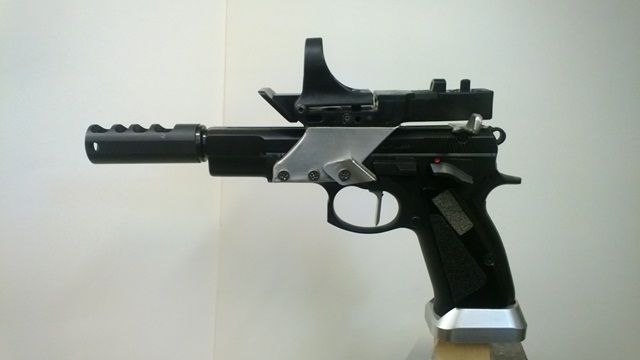

Hi,
Used some old and new parts.....
Old well used 85 slide, new 75 frame, new TS 9mm barrel, comp, alu grips, magwell, trigger, springs, c-more, wide safety, longer mag + 2pds +1 spring and follower (4 magazine sets)...........
Ready for next summer for fun shooting with low budget :P
- Kapa -

« Reply #8 on: December 04, 2013, 08:25:58 PM »
How effective is the comp?  Are you running 9mm major or minor?
Offline Bishop112
  • Posts: 599
Re: CZ85+75+TS = OPEN GUN
« Reply #9 on: December 04, 2013, 09:10:49 PM »
Thats cool! I have been toying with the idea of doing something like that with my 75B .40 SA.... What compensator is that? and did the barrel swap work ? isnt the barrel for a TS barrel heavier (thicker) than an 85? I would love to see some closer pics. Thanks!

« Reply #10 on: December 05, 2013, 08:39:05 AM »
Hi,
Comp work's really great, almost totally flat  ;D, comp was from competitive shooter web shop, cheapest one.
Barrel is from TS and is thicker and longer than original, needed gunsmith for fitting barrel to slide and comp to barrel.
I will try to take some close ups when get back home after few weeks.
I can also try to place hat-camera video to somewhere to link  :)
Loads I use are 9mm major self loaded 124gr bullets making PF 165.
- Kapa -

« Reply #12 on: December 05, 2013, 04:27:50 PM »
very nice! didnt barely see the gun move! now you really got me jonesing to set up my .40 like that!

« Reply #13 on: December 05, 2013, 04:55:29 PM »
If you don't mind me asking, what powder and OAL are you running?  Silhouette and HS-6 are pretty common for short chambered CZ's.  Any reason why running the 124's instead of 115's?

« Reply #14 on: December 05, 2013, 05:28:09 PM »
Hi,
Have to check the loading data when back in home, after few weeks.... The 124gr bullets happened to be available  :) with reasonable price.
