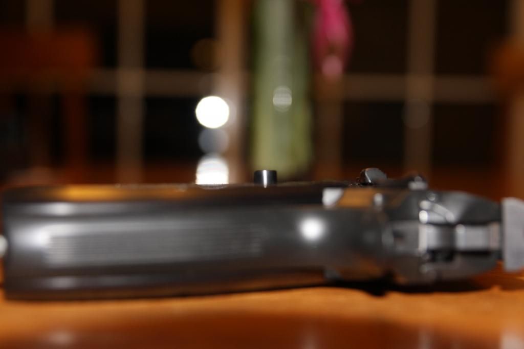

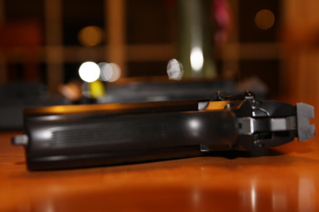

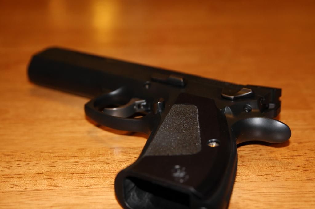

Some pictures:
Stock doesn't protrude past the grips:
Extended protrudes quite a bit:
So far I haven't played with it much, I just installed it.  With the limited dry fire practice I think I am going to like this setup.  It feels like my SP01 now just a little larger.  I don't have to shift my grip at all and I easily get enough force on the button to drop mag's.  It looked like it protruded out too much at first but it doesn't seem to get in the way of the grip at all.
