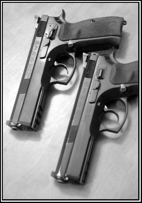

Hi - I'm new to competition shooting and was wondering if anyone knows how much youre allowed to tweak your gun in the Production Division.
Got my stock, out of the box CZ 75 SP-01 Tactical few weeks ago and just put on CZs Competition Rear Sight + Fiber Optic Front sight (same as the Shadow), also had a Trigger job (its about 3.5 lbs now). Is my gun still legal in IPSCs Production Division?
And if it is, how much more can I tweak it?
