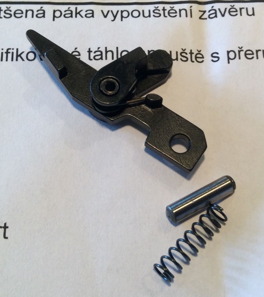

Offline CitizenPete
  • Posts: 1260
Help... ideas?
« Reply #5 on: April 29, 2015, 01:33:20 PM »
Hoorah! My Zendl package finally arrived after OVER ONE MONTH!  It was in the US lost for almost 2 weeks between PA and the USPS Ohio sort facility. Even my mail carrier and the post office was happy for me. Next time I will pay for EMS Express shipment.
Anyhow...
I have no problem installing the disconnector, I know where and how it goes in.  But low and behold it came with a solid stainless pin and an additional spring -- these were not covered/shown in the product listing or instructions.
It is not a replacement for the roll pin in the hindged disconnector -- too long.  and the spring does not fit over the pin. Neither of them attach to the disconnector in anyway I can see.  My guess it has something to do with the cross pin holding the trigger and disconnector in place?  Ideas?
I sent an email to Zendl but the translation might be a problem.
Guesses from anyone familiar with the various variant FCGs as to what these are for?

Re: Help... ideas?
« Reply #6 on: April 29, 2015, 04:48:55 PM »
This.

ZENDL Spring Loaded Disconnector
The extra SS pin they sent is a replacement for the trigger/disconnector retaining pin (not the receiver cross pin) to be used to replace the original if you destroy the old one driving it out. However it is longer. (?)
The spring is a replacement for the stock trigger spring and Zendl says that it is lighter,  designed to reduce the trigger pull.
Today I installed it with a Bonesteel/CNC Warrior  FCG in an Sa vz.58.  Installation was not an issue -- just the normal BS with e-clips etc.  The extra pin and spring do not apply to the BS/CNC trigger assembly as the design is different from the sa. version.
The function of the Zendl DC (DisConnector) is interesting.  Since the "tab" that sticks up out of the top of the DC is normally fixed, the DC is not only forced down when the carrier travels over it, it also rides front to back.  With the Zendl DC having a hinged spring loaded tab on the the top the DC is pushed straight down as the tab folds forward on top of the DC.
I think this is to address the timing issue with the carrier travel over the DC.  Since the top tab folds over the DC and in effect rides along with the carrier as it travels forward over it.  This increases the "residence time" of  the carrier movement pressing down on the disconnector eliminating the Gremlin or HERMEX. (with or without the carrier being tabbed).
As for the function of the trigger,. I don't see a big difference in performance, take up, reset, etc.  If anything the pull is harder without the Zendl replacement spring.  The BS/CNC trigger is a bit of improvement over the stock trigger already and the Zendl DC doesn't noticeably change it much.
Next test will be with the CSA trigger group which is the stock design this upgrade was intended for.

  • Posts: 1260
I have been using the Zendl DC (dis-connector) in a CSA sa. vz.58 (OEM tabbed carrier) in conjunction with the CNC/Bonesteel sear and trigger and it operates smoothly with no issues.  No trigger slap or other problems were observed to date. There is no discernible difference in trigger pull, take-up or reset that I can tell, so this upgrade may only be providing a Hermex/Gremlin solution.  (a bandage over a bandage?)
Other than addressing the Hermex/Gremlin, which is supposed to be eliminated by the OEM tab on the carrier, I have yet to see any ROI advantage of spending the money on this upgrade.  I have had 11 VzXXXX (vz.58 variant) carriers tabbed and painted for an average cost of $22.27 each, so the cost of the Zendl DC (and shipping cost from the Czech Republic) is hard to justify, unless it offers some other advantage that I am not yet understanding.
My plan still is to try it with Czechpoint-USA FCG (Made in USA) to compare trigger operation between with and without the Zendl DC.  On the list of to-dos for the future -- no rush.
