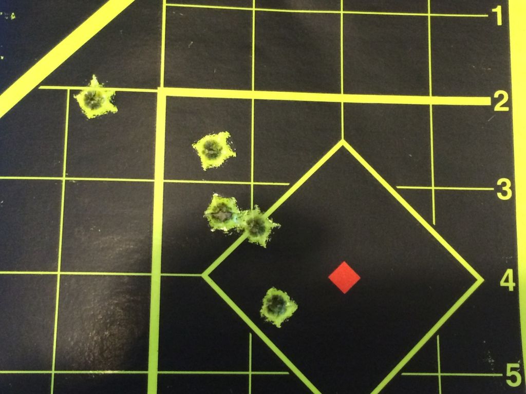

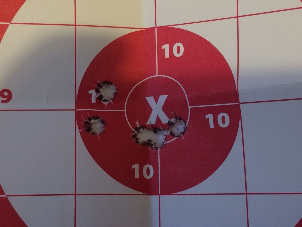

« Reply #37 on: March 27, 2016, 07:41:10 PM »
eh !@## happens, here is the best group of the day, right under an inch
and the worst, a little less than 3 inches  :(
i don't know why this picture only shows up upside down.
while this barrel was done on a cheap green mountain blank, I would expecta bit better than this, so I'll go and recheck everything (already eliminated the optic by trying a couple while I was out at the range.) shoot it with the muzzle brake off, borescope the barrel and make sure the crown wasn't damaged somehow, look at the throat to make sure it was cut square, etc.
it simply could be it doesn't like the factory hornady load or maybe just the bullet weight I'm shooting (though the diagonal stringing is a bit of a head scratcher).  on my precision .223 barrel it absolutely hates my 75 gr hpbt load that shoots well in just about every gas gun I've ever done, but loves 53 gr v-max bullets.  So I'll try some other bullets as well.
one thing I did notice was some pretty significant denting of the brass on loading, so I'll look into getting that fixed at a minimum.
not giving up on it just yet  :)

Both pictures show up here right side up. I'd be happy with 1-2 MOA with a military style semi auto rifle, but I'll bet you're gonna tinker this thing into being able to shoot National Match. :)
Re: And now... Something different
« Reply #39 on: March 28, 2016, 02:28:45 AM »
The stringing, is it happening in ascending/descending order? If so, might suggest barrel heating up...
If not, it might have to do w/ barrel oscillations which often seems to be in a figure 8 pattern, albeit not exactly repeated from shot to shot...  So furthest movement from center are fastest and nearest to center are slowest...  Part of tuning barrel and cartridge together.
BW -- are you using the standard gas block or is yours diy?  In 5.56 standard, the bren is advertised to have a "pencil" barrel.  When you up caliber and if keeping same barrel diameter, that would suggest increased flex...
However, you blank looks thicker, so this may not be the issue, but thought I'd throw this out there.
Look forward to your continued updates on this build.

barrel diameter is quite a bit thicker on mine as I open up the gas block.  shot placement begins high left and drifts to low right while firing. firing was done about one round every 3-5 seconds, with 3 5-shot groups shot before letting the barrel cool.  the barrel heating up is likely causing part of the issue as the largest group was also shot while the barrel was the hottest. there are a few things I'll be modifying
