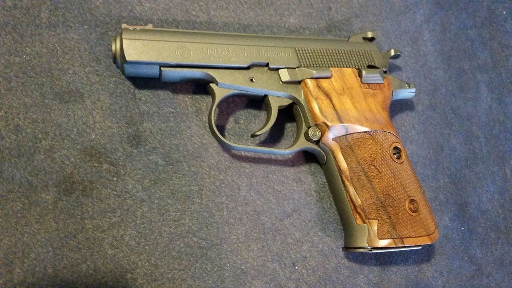

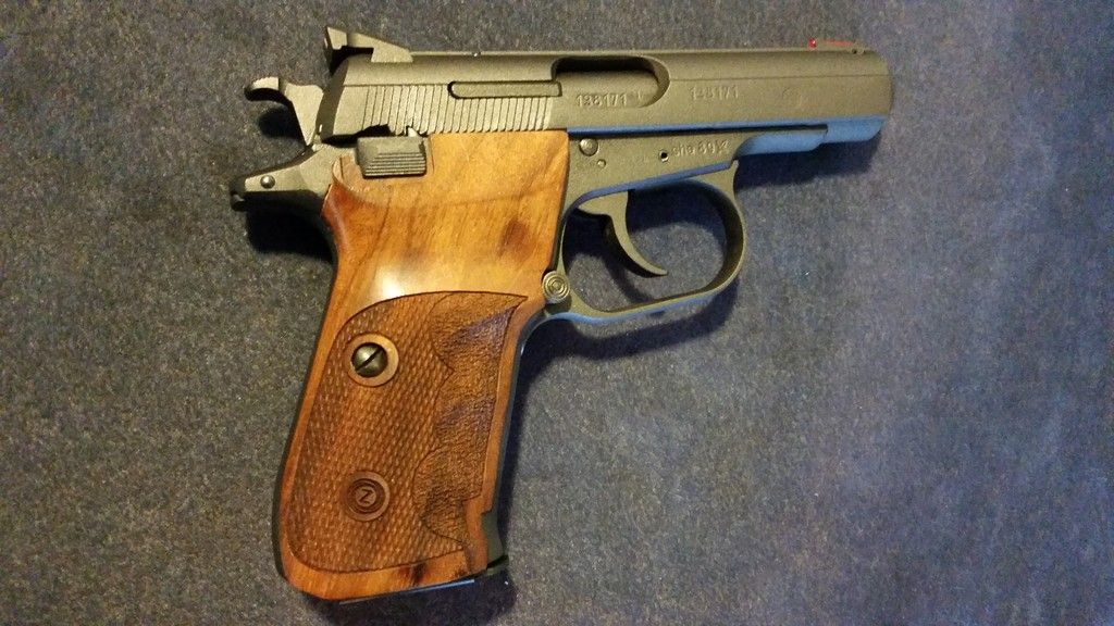

This is a '93 that I added the grips to. Along with CGW front FO sight, and combat rear sight. The Ceracote color is Cobalt. This is a wonderful handgun, very accurate. Wife has almost adopted this one..

Offline Blackwatch
  • Posts: 1506
Re: CZ 82/83 refinish? How? Why?
« Reply #8 on: July 21, 2016, 10:04:10 PM »
That is a great looking piece!!

« Reply #9 on: July 21, 2016, 11:45:24 PM »
That's a good looking piece. What kind of sights are those?

« Reply #10 on: July 22, 2016, 08:57:13 AM »
Thanks for the comments.
Front sight is CGW original height fiber optic. (050-390)
It replaced as well as any other, including full size 75B. They all require some dressing to fit.
Rear sight is CZ Custom (CZ83 H-Tac Tactical rear.)
This is an amazing handgun now.
