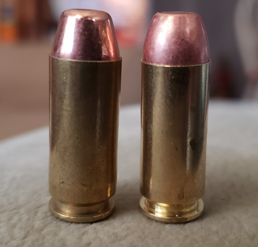

I picked up a box of Federal 10mm 180 grain FMJ, loaded up my mags (1-10round, 2-15 round) and went to the range. I first shot my reloads to confirm/duplicate previous results, then loaded up the Federal.
Results, with my reloads, several failures to feed in each magazine (4 in the 10 round, 2 and 5 in the 15 rounds). With the factory ammo, ZERO failures to feed!
I'm thoroughly frustrated now, even though what I thought could be the issue has been eliminated from consideration, I now need to find out why my reloads do not feed. Dimensionally, they are essentially identical to the Federals, but the Federal i 180 grain has a rounded ogive. My reloads are 165 grain Berry's Flat point, like a truncated cone. Side by side, that flat point shape appears to be "thinner" than the rounded shape.
The Federal claims 1200 fps. I am reloading with 8.6 grains of Power Pistol over the Berry's 165 FP. That may be a bit light per Alliant's data, but it doesn't seem to be too light according to the manuals I have, or data I find online. It is certainly above any starting load I have seen.
Sorry to be taking this thread about Witness 10mm springs off topic. If you think this should be in it's own thread, or in another existing thread, let me know.

Rock-it3,
Assuming no pressure signs you could try bumping up your load or using a lighter recoil spring.  Assuming this is a classic failure to feed which can have multiple causes.  Also check your mag spring tension which can cause issues from load to load, depending on the dwell time the slide has all the way back.
Would probably open this up in the reloading forum.
Hope this helps.

It's an ammo problem, not a spring problem. I suggest you ask for some help with loads in the ammo forum.
Rock-it3
Re: Source for +strength magazine springs for 10mm Witness
« Reply #14 on: January 30, 2021, 08:16:36 PM »
Will do. Thanks for pushing me to try some factory ammo. Sometimes tunnel vision prevents seeing other possibilities.
