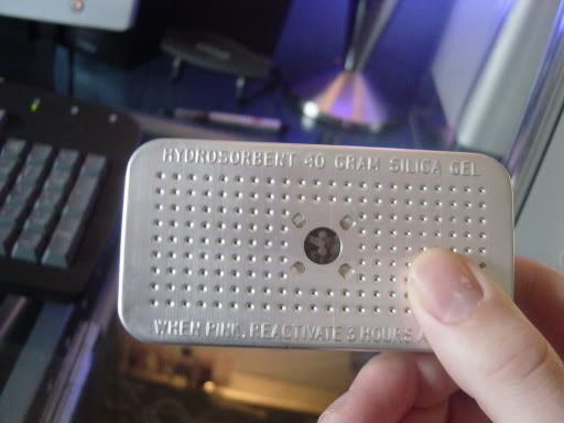

Offline Arcticleo
  • Posts: 34
Question about silica gel packs for firearms storage
« Reply #27 on: October 08, 2005, 11:47:56 AM »
KPIII,
I've been using those hydrosorbent silica gel packs in my safe also and they seem to be working great. I've never had any problems with my firearms showing moisture damage.
i5.photobucket.com/albums...C04958.jpg
Here's an up close on one I pulled from my safe. I've had them for about 4 years in my cases and just continue to recharge them when the center turns pink, which isn't frequent. When I picked up my safe a while back I started using them in there instead of running a dehumidifier in my safe. I still do a field strip each month on my firearms and apply shooters choice rust prevent on the whole firearm before prolonged storage.
-Arc
