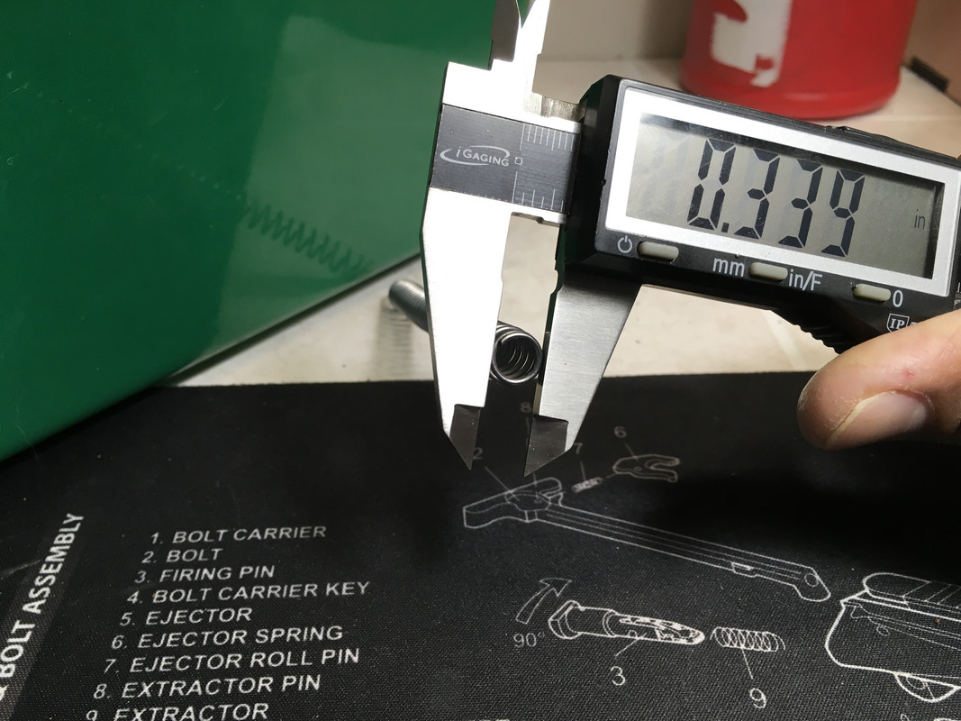

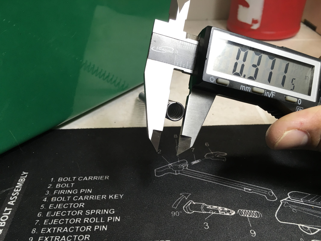

Is your TSO a 9mm or .40?
I just check my 9mm TSO stock 16# spring and one end of it is noticeably smaller in diameter compared to the other end. The smaller diameter end always goes into the guide rod first after speaking to a Wolff tech rep when I was troubleshooting my 1911. The smaller diameter ?locks? or keeps the spring in place during recoil.
M1A4ME,
It can happen. It happened to me when I cut a coil on a 1911 spring and I didn?t bend/tucked in the pointed end of the spring. It went into the recoil guide hole while I was shooting. That experienced led me to asking questions from the Wolf?s technical reps which included proper installation and orientation of a recoil spring on a guide rod.
Anyway, here?s a couple of pics of my 16# TSO recoil spring with measurements.
Smaller diameter end
Bigger diameter end

It's a 40 TSO.
Mine was noticeably smaller in diameter so much so that it wouldn't fit over the larger step on the guide rod.
I'm just guessing but I think it got swaged down further probably because I installed it backwards originally.  Obviously once it was pushed through guide rod hole it got mangled.   I've got that end up against the buffer now and yes I bent the clipped end  inward so it grabs the guide rod.  This is just until my wolff springs show up.
