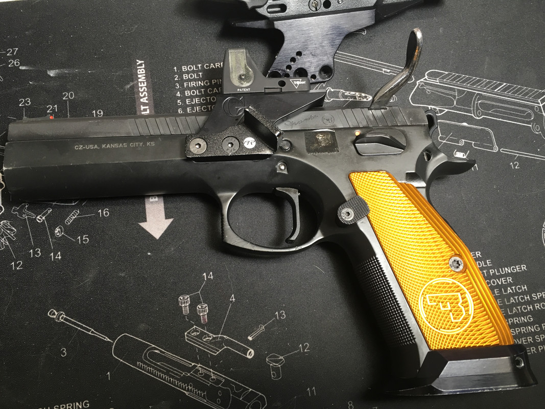

Gas petal is causing support thumb to constantly bang up against slide release.  Removed gas petal and noticed small hole between 2 screw holes and possibly a roll pin in hole.  Is it safe to shoot without gas petal?? Wouldn't want a part to come flying out while shooting! Thanks for your attention

I'm fairly sure you can remove it without issue.   I chose to remove the slide stop and run the straight pin instead.  I just put a piece of grip tape over the slide lock hole.   It really declutters and frees up space on the grip.

You can remove it without any problems. Like Toby, I removed the slide stop and covered it with a piece of grip tape.

George:  Thanks for the pic - for some reason I'm not allowed to communicate with you directly!  Question; how is your pistol able to function without the slide stop? Turns out my issue isn't with the gas pedal (which i like) but with banging into the slide stop under recoil.  Removing the stop would solve the problem but what holds the slide to the frame?

The pin version is the same pin-section as a regular slide stop that's held in on the other side of the frame by a tension wire that fits into the detent groove on the pin's end.  So there's still a pin holding the slide from sliding off the frame.  Like a regular slide stop, it is removed by aligning the reference notches on the slide/frame and pushing on the protruding part from right side of pistol.  So it is the same as a regular slide stop, but without the outer lever and your slide will not lock back on empty mag or manually.
Not a big deal for those who never plan to shoot until slide lock anyway and just reload with large-cap mags where appropriate in a stage, if even needed.

The TSO comes with both a straight slide stop pin and a slide release lever slide stop pin.   It's just a matter of installing the straight pin.
