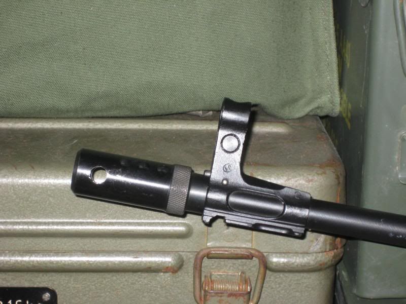

Actually, the Slovakian Muzzle Brake will go on, it's just that you have to force it on a bit and the Slovakian Muzzle Brake's threads will conform to Your Vz2008's Muzzle threads when screwed on for the first time.  You will also be able to go back to the old Slant Brake if desired.  I just put a screwdriver thru the front of the Slovakian Muzzle Brakes holes and put it on.  Had to find out myself, the hard way.  Note the direction your Slant Brake screws on.  Your Slovakian Brake will go on the same direction.

Just put on 4 on vz2008 rifles earlier today.  Two matched up and went on without issue.  Two had to be tapped with the bottom top. Cut a bit of metal too, and as John mentioned it was hard steel. I used a lot of oil when cutting.  One muzzle was still too tight so I ran a die over that muzzle, which had a high spot toward the muzzle end.  Those Century slant brakes must really have loose tolerances.
