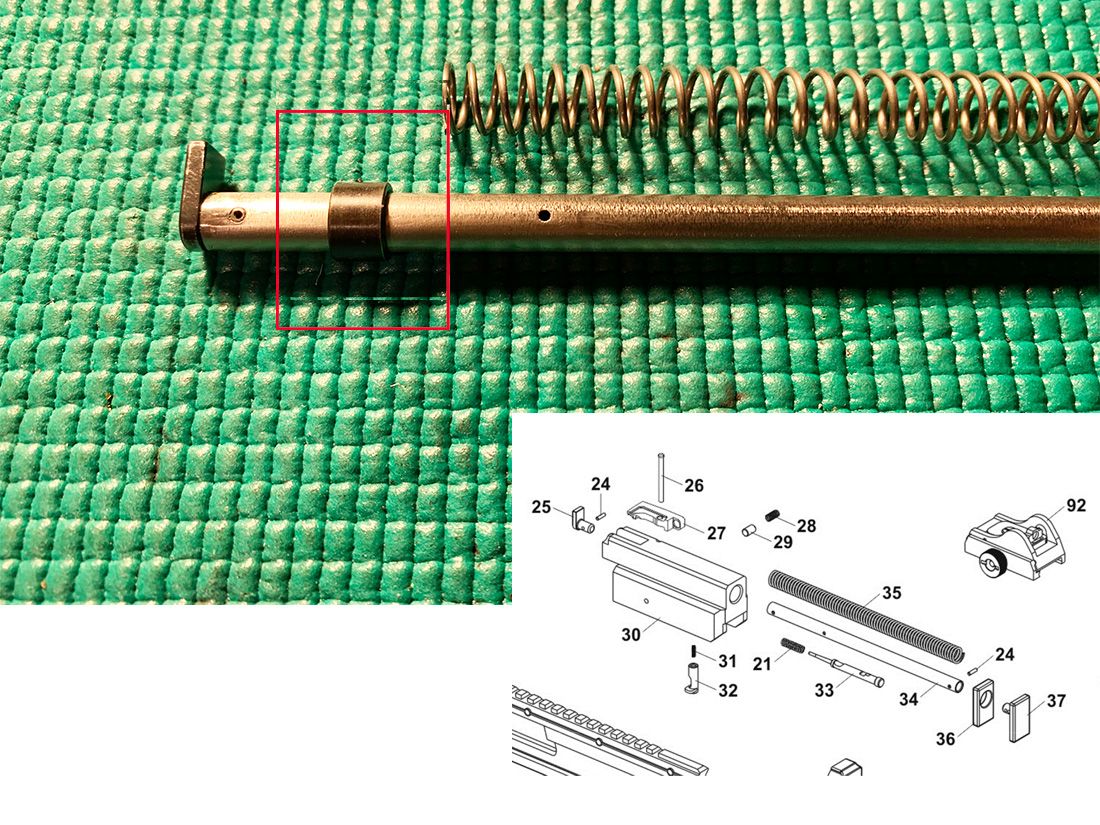

Bit of an update. After a very thorough cleaning and a complete bolt disassembly, I went back to the range. I also used a different magazine (newer CZ black window magazines). Good news is that out of 100 rounds I managed to get down to 2 failures, same 115 grain range ammo. Much improved, but still looking for zero malfunctions which I know this PCC is capable of. This time it wasn’t a failure to extract (it seems to be extracting fine now after cleaning) but looked more like failure to fire. Bullet looked to be seated in the barrel when I peeked inside chamber.
When I got home I did another complete bolt disassembly and I had noticed something unusual, like an extra part. The manual didn’t call for, or even listed this as a part. It looks like a washer that slides in before the main recoil spring. A washer that in my guess, looks like it is intended to create more spring tension. Anybody know what this is? My brain is telling me, this is what may be causing 115 grain loads to possibly not have enough energy to fully blow back the bolt causing my jams. Was it a post add on part either from CZ or from the original owner?

I'll be honest with you, I have never had a need to disassemble my recoil spring /guide rod assembly, but you are correct, that part does not appear on the parts diagram. I believe your hunch that it was added to provide additional tension to the recoil spring may be the source of your failure to extract the lighter bullet ammo problem. Was the "spacer" on the guide rod, inside the bolt, in front of the recoil spring? This video animation of the complete disassembly and reassembly of the Scorpion and sub-assemblies doesn't show that spacer either. https://www.youtube.com/watch?v=u_bsC3ppfwo

Yes. Precisely, on the guide rod, inside the bolt in front of the recoil spring. Have removed the anomaly and will hit the range this week.

Just want to say thank you to those who helped me figure this out. Glad to say that after my last range visit, I report Zero malfunctions, after 100 rounds. It was the darn spacer that somebody decided to modify.

I would assume that is an intentional modification from a prior owner who liked to shoot +p or +p+ ammo or suppressed and needed some extra spring pressure to mitigate the slam-back of the extra recoil, I shoot mostly NATO spec ammo, but have a very effective muzzle brake so it feels like a .22

I’ll agree with everyone saying that spacer is not a normal, factory part. FWIW, on these blowback pcc’s, dirty extractors will cause failures to extract. I recently tore my own EVO bolt apart after about 2,500 rounds and scraped out a bunch of greasy gunk from on and around the claw. I had been having FTE every 2 or three rounds. After cleaning, just dumped 200 flawless rounds through it. Seemed to remedy the problem.
