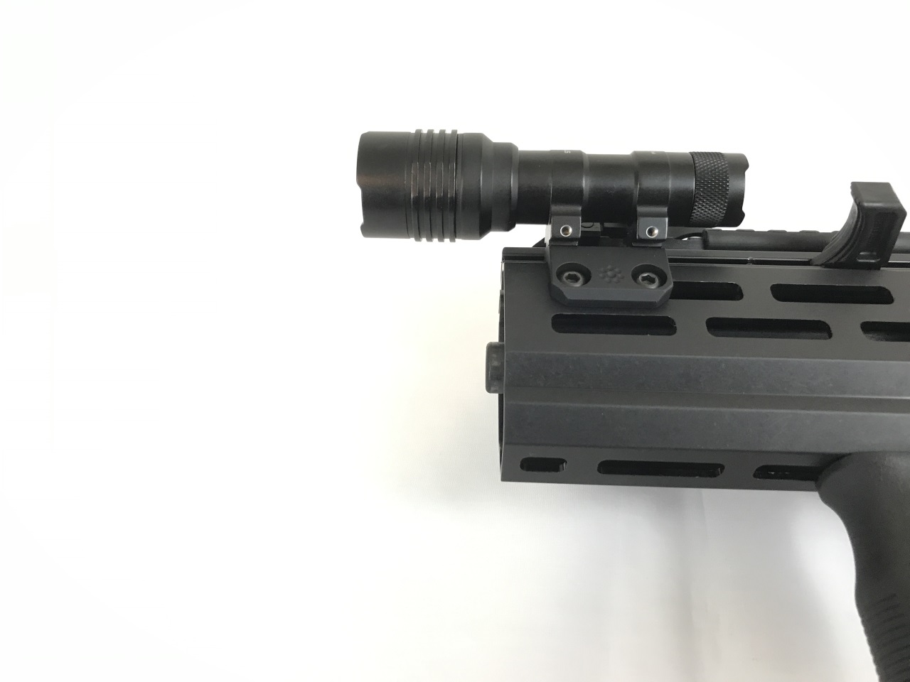

I had the factory pistol and carbine handguards as well as the HBI 6.84" Angled forend before settling on the 6.84" Flat.  I had my barrel cut to 6.5", threaded 1/2x28 and, added a 3-lug for my Octane45 with Griffin 3-lug mount.  The tip of the 3-lug barely sticks out past the end, and the suppressor is only 1" inside the handguard so I don't get too much heat radiating off it.  I have long arms and the 4.25" would have been too short to comfortably activate the light. The Flat forend gave me an extra MLok slot to push the Arisaka mount far enough forward to hit the tailcap and minimize barrel shadow.  The extra top rail length moved the front sight out of the way of the charging handle.  Taylor Pickerell "eMGunslinger" here on the forum did the barrel work.
