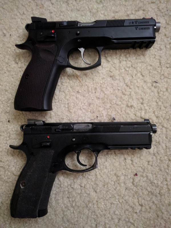

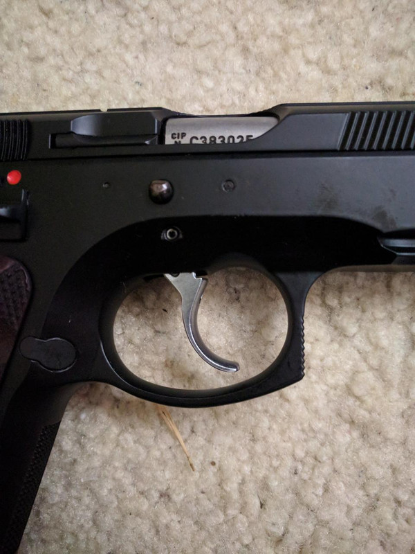

John, I am in exactly the same position as you...7 years shooting an M&P9L and have just bought a SP01 Shadow (about the last new stock available here)
I have only briefly shot an SP01 once years ago, and had a go of someone's Shadow 2 the week before last...but it just fits my hand so much better than the M&P and since 99% of Production shoots Shadows...well lol
I agree, SA is just freakin ridiculous! And I have no wish whatsoever for it to be any lighter...just bought a trigger gauge and its an average of 2lbs 9oz  :o
DA is another thing however lol...I have small hands and a bit of a wrist issue so am trying out springs to get it down; installed an 11lb recoil spring and a 13lb mainspring/reduced firing pin spring, which came out at roughly 9lb which was still too much and caused pain down the carpal tunnel part of my arm. 11lb next and it dropped about 1.5lbs to 7.5 but still needs to be lighter for the front sight not to move when dropping the hammer, and to (hopefully) pretty much eliminate the pain. I will try 10lbs next which I think might be the ticket.

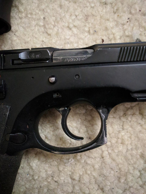

As far as reach goes, reduction will also help DA as you've found out. If the reach reduction kit is legal for you, I say go for it. A mate's Canadian friend is coming out to our Nationals in March and has a US post box...he is buying a 75 recurve trigger for me from CZ custom as they will not ship outside the US...this is the difference:
Mate's gun with recurve at bottom...gotta say his DA is incredible, but it has also had 60,000 rnds through it plus springs adjustment lol
https://czcustom.com/cz-parts-all/triggers/cz-75-recurve-trigger-05a.html
If you can do internal polishing that will also help a lot, however that is illegal for us in IPSC.
You ask what is an out of the box Shadow trigger with no work is like? Completely night & day to the M&P, not surprisingly. Perfectly smooth and crisp both in DA & SA...whereas my M&P trigger was positively gritty when new, and I spent two nights in front of the TV just working it to get some of the crunchiness out of it lol
