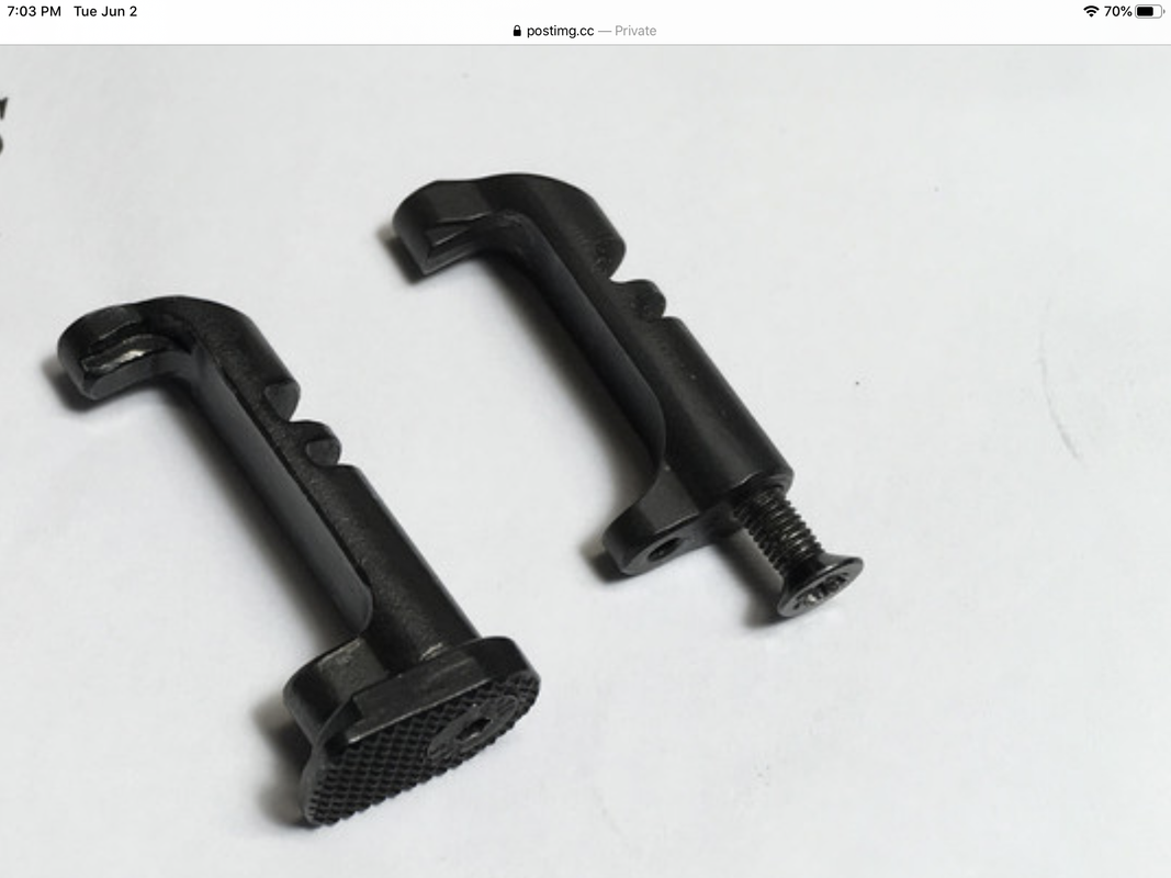

If you’re going to do that route of grinding the mag release down, you need to drill and tap a hole for the pad screw and another for the roll pin which prevents the pad from rotating.
I have done the grind, drill and tapped for my TSO and Czechmate so I can use the shadow 2 pad on my TSO and Czechmate’s mag release.

Thank you George!  The picts answer my questions.  Without seeing one I assumed a pin or cutout for
anti-rotation.  Time for a couple beers and the thinking cap to fabricate a paddle to function with a round release.
