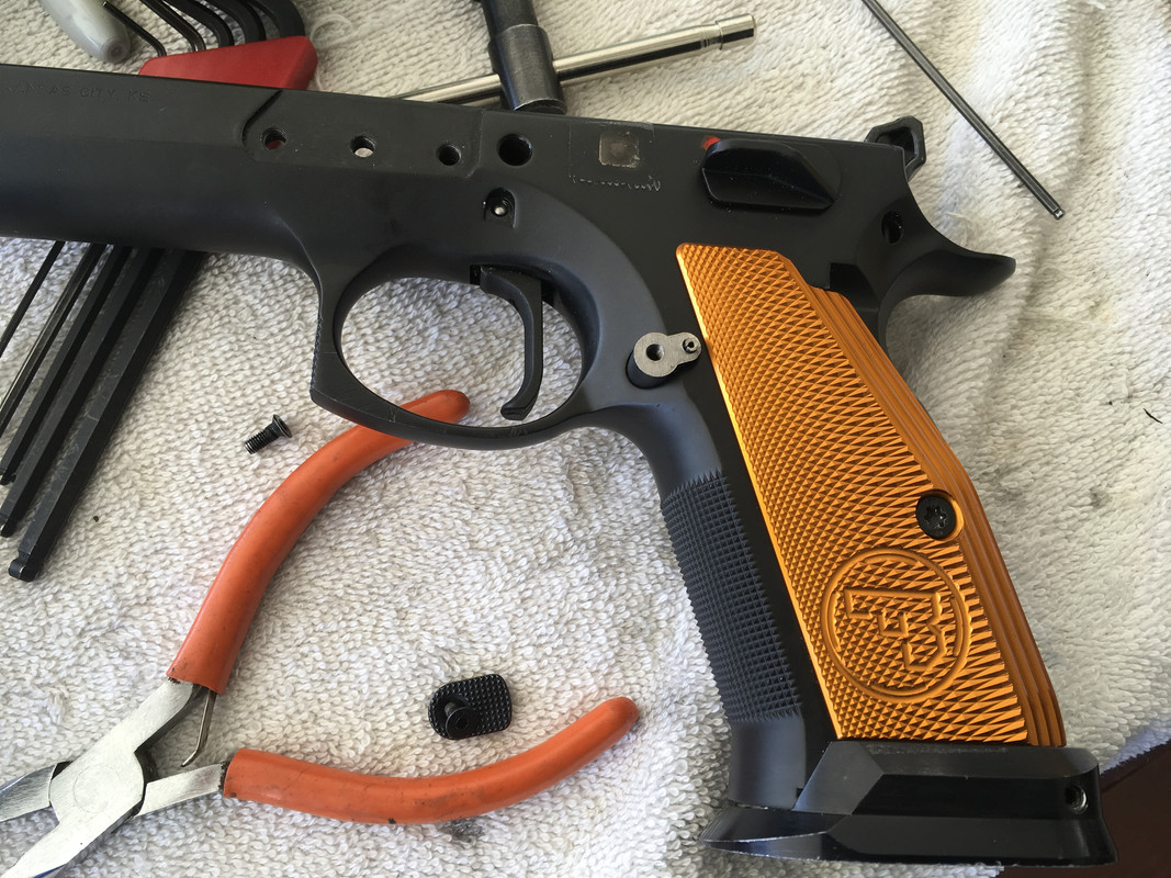

I did the drill and tap for the mag release on my 2018 TSO. It’s hardened steel and either use a carbide bit or anneal it first. I used the pad from a shadow 2 mag release. I also had to grind it down a little bit to compensate for the thickness of the pad.
Pics:
It’s not hard if you have the correct tools I.e. drill press, carbide bit etc.

That’s true. Having the proper tools makes a huge difference. That plus the time to get it done. I also modified and installed pads on two TS mag release for a guy over at the Enos forum.
