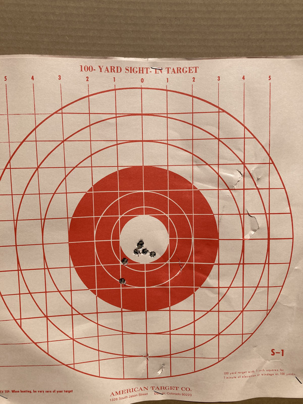

After getting it roughly on target, I decided to kinda dial it in today at 100 yards. I cranked the scope up to 9, (because I can), and the glass was still crisp and clear as the day is long - I am liking this WHISKEY 3 scope. After getting where I wanted, I shot three, three shot groups for posterity. These were shot with Hornaday 150gr Interlock Whitetail series of factory ammo.
1st, 1 and 1/4", center to center.
2nd, 1 and 1/8, same.
3rd  1 and 9/16th.
Measurements roughly average 1.38". Pretty good for starters.
Then, I used the MidwayUSA logo on the target as an aiming point for my 150gr Interlock 47gr of TAC handload. 1 3/8", 3/4 right and high and 1/8 inch from POA, roughly.
I think I'm on to something...
