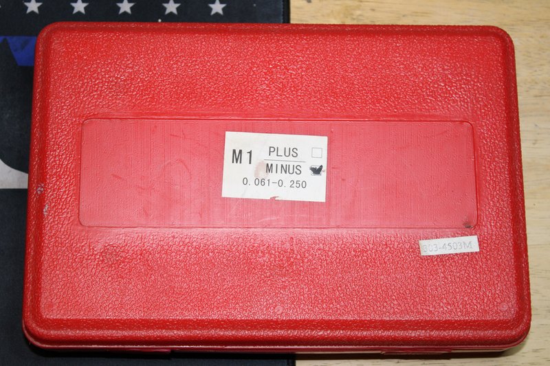

A 1/16 hole is a .063 pin gauge, the set I have begins at .061" or .002 of an inch smaller than what you're looking for. The set goes .061, .062, .063, .064 .065 on up to a quarter inch diameter. Thats the range you're looking for. Pin gauge sets use to be pretty common now there are cell phone apps that measure stuff like this, I've never used one of these apps, but could that work for you?
