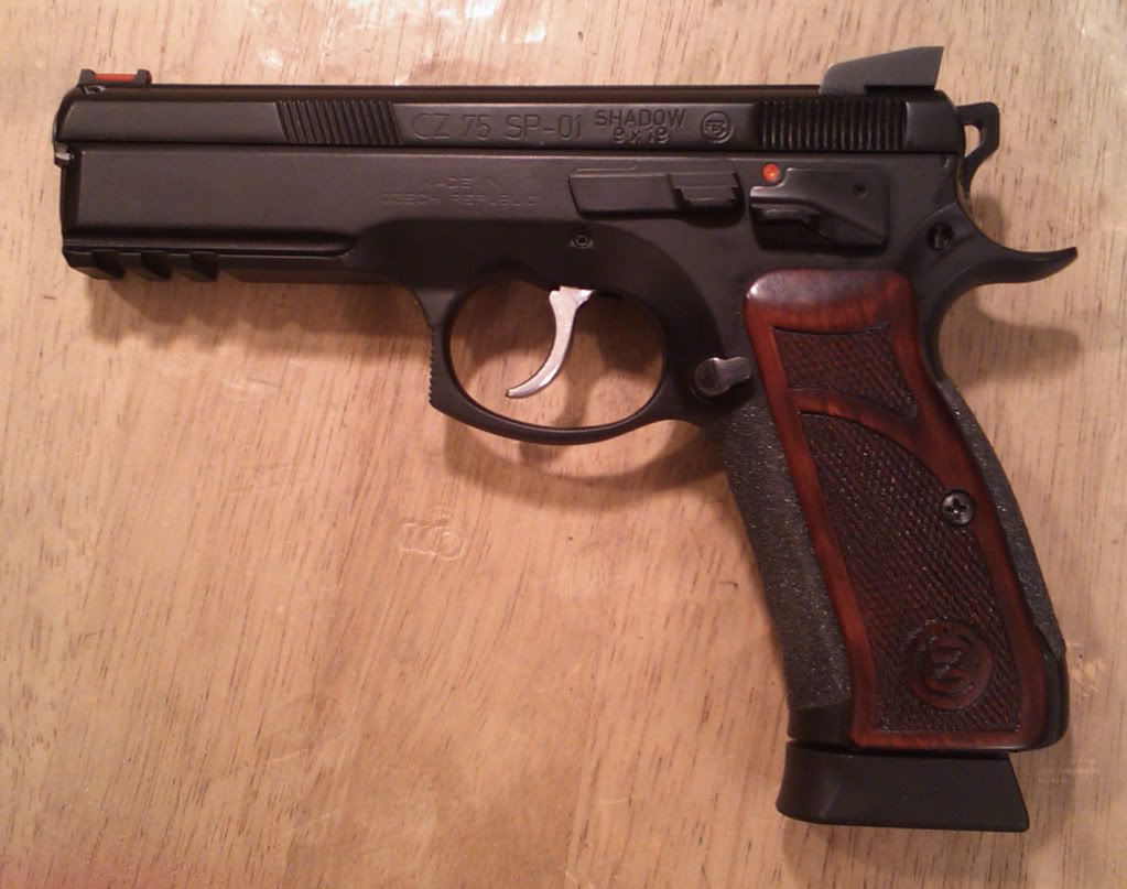

Ok, its been a while. Still no one has given me any input so maybe this will spark your interests. Here is a pic of my new Marschal Grips from Hungary for the SP-01. These weigh exactly 0.40 oz. I chose the alder with the red finish. My SP-01 now weighs 39.54 oz
