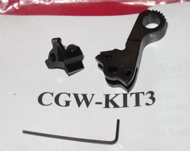

These are the contents of the CGW #3 Trigger Kit.  What you get is the Adjustable Sear, a modified Shadow Hammer (reground to fit a standard 75B Slide), and a tiny Allen Wrench to adjust the set-screw in the Adjustable Sear.

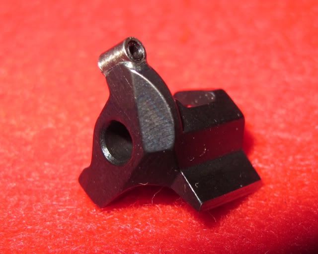

Here's a closer look at that Adjustable Sear.

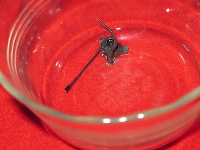

As per the directions in the kit the Adjustable Sear with Set-Screw removed are degreased in aromatic Solvent, such as Acetone, Lacquer Thinner, Berryman's, Gun Scubber, etc.  You can't see it here, but these parts are actually submerged in solvent in this photo.  They were then dried.

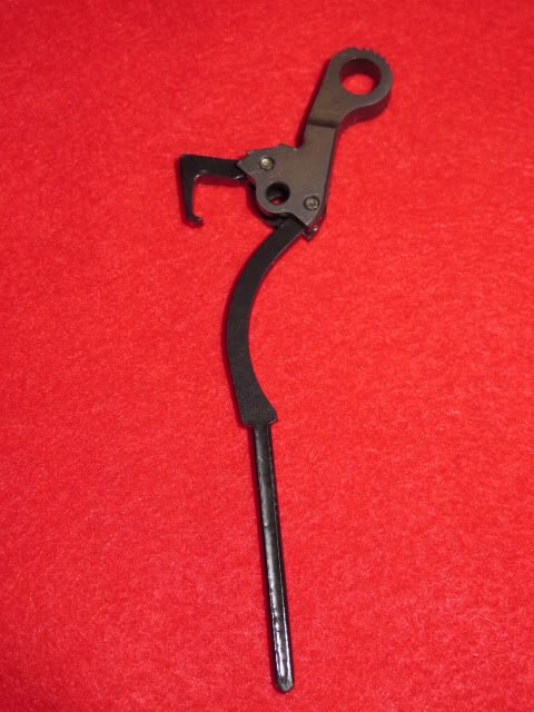

Here is the modified Shadow Hammer, with the Disconnector and Hammer Strut attached.
For me this was the most time consuming part of the entire operation.  Getting the pins out of the stock Hammer was a real pain and took the most time and effort.  You need to have a good SOLID surface (I used a small anvil I have for just such operations) and then Gunsmith's Bench Block (or piece of wood with small holes drilled in it) and the correct size Punch to drive out these pins.  I had no problems starting and tapping the Pins back into the new Hammer, just getting them started coming out of the stock Hammer.  Once they finally started "out" they came out o.k.

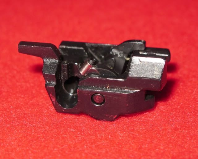

Then the Ejector/Sear Housing has the Sear and Spring removed.  Instead of doing any polishing on the Sear or Hammer surfaces, with the kit you just change out the parts.
Here, the new Adjustable Sear has been installed and the Housing is ready to be reassembled back into the pistol.

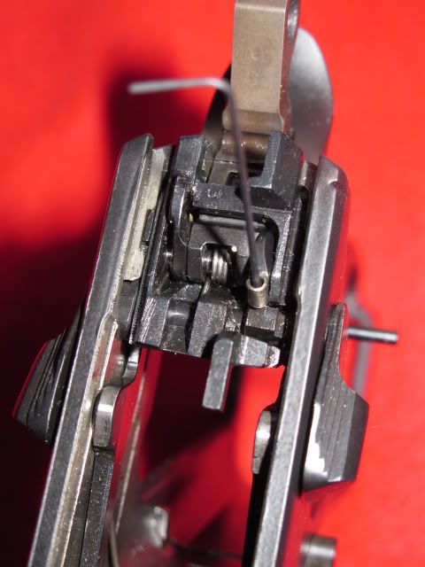

In this photo the Hammer and Sear Housing have been reassembled back into the Frame and I'm about to reinstall the Mainspring assembly.

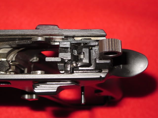

With the Set Screw still backed out, I'm getting ready to apply a small droplet of BLUE Loctite Thread Sealant onto the Set Screw.  Caution:  You want to make sure you DON'T get any Loctite on any other moving parts!  Only on the threads of the Set Screw!
In this photo I have already adjusted the Set Screw but I have left the Allen Wrench in place to see it "as it was" just as I adjusted it.
Note:  The Hammer is COCKED, and the Safety is "On".  The Set Screw is screwed in until it just touches the Lobe on the Safety's shaft, then it's slightly backed off (it does not rub against the lobe in static position.  Thus there is no wear on the Set Screw)
The "Test" to ensure the Adjustable Sear is properly adjusted is to check to make sure the Hammer doesn't drop when the Safety is "On" and the Trigger is pulled.
I went back and added another "drop" of Loctite Blue into the hole left when the Set Screw was adjusted in.  I then carefully wiped off the excess with the twisted tip of a small sheet of paper towel.

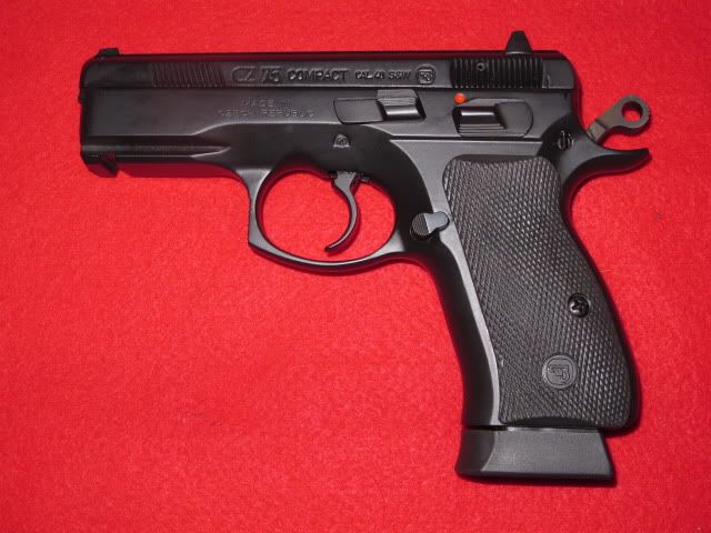

Given time for the Loctite to set (a few hours, overnite to be "safe") the pistol's reassembled and aside from a knowledgeable eye catching the modified Shadow Hammer, this Compact .40 appears to be totally "Stock".
