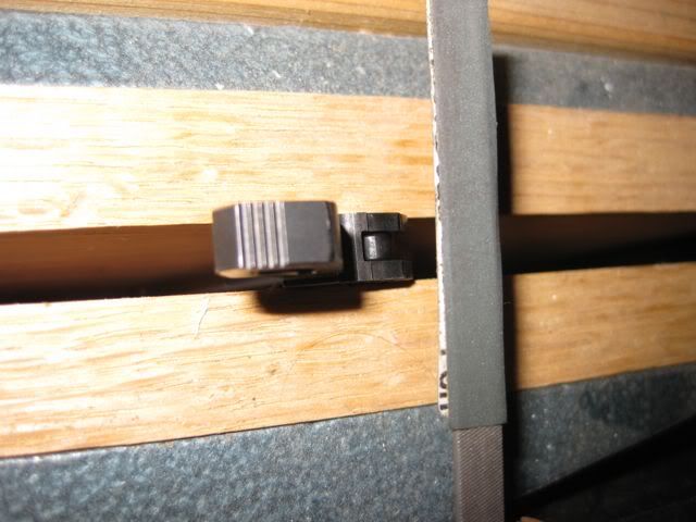

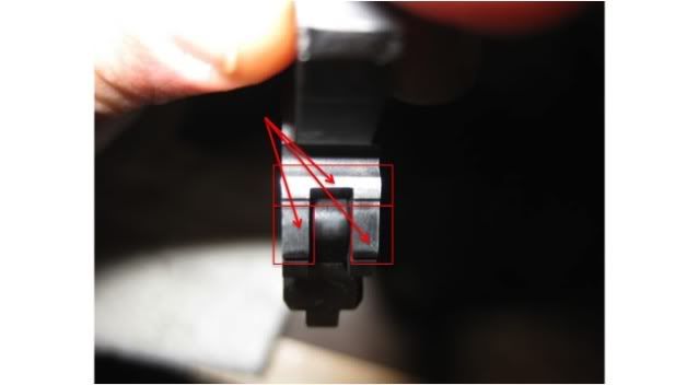

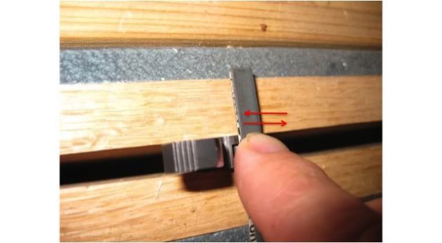

I did a little more work to the hammer. I carefully sanded the hammer bed with 1000 grit paper. Be careful not to damage the hooks and go very slowly.
Sanding in the directions of the arrows gave me the most control.
A better photo of the file with the sandpaper glued on using rubber cement.

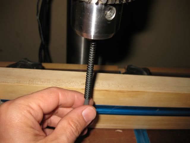

For working on springs I chuck them in the drill press and use rolled up sandpaper to debur the inside. Set it to a low speed or your going to find out drill presses are really used to hurl projectiles at you. I set mine for 200 RPM. Here is the mainspring:

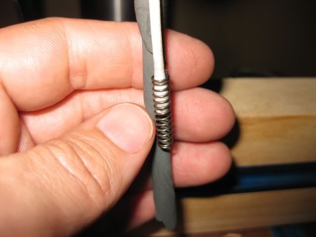

A q-tip can help with the outside of the spring. I chucked the q-tip to the drill press and placed the firing pin spring over it. Now I can work the entire outside length of the spring.
