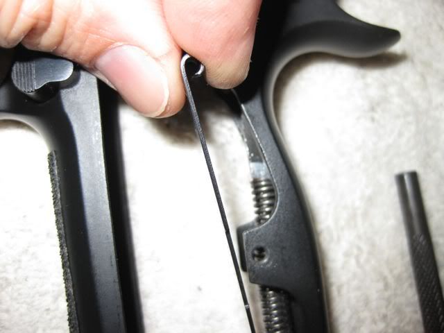

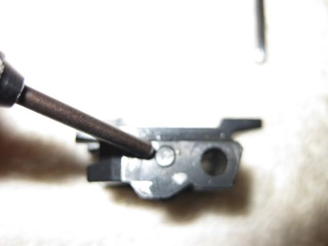

During disassembly the only part you that will need a hammer or mallet to drive out is the trigger pin. Everything else should move out with minimal force.

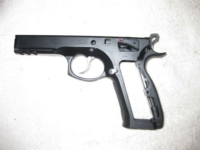

Field Strip and remove grips
Remove magazine plate
remove mainspring and plunger by applying pressure to the bottom of the plunger and pushing out the pin

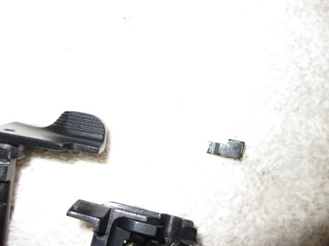

Remove Safety and Sear Cage by lifting the sear spring from the groove and easing the safety out. It might help to pry with a firm piece of plastic to get it started. If you have to force it out something is wrong, check the spring again.

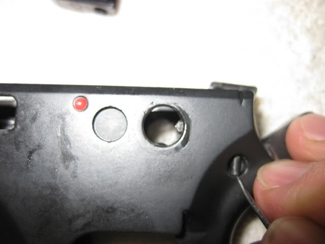

Remove the right safety detent to keep it from disappearing when you remove the trigger
Remove the hammer, strut and disconnector by lifting up on the retaining pin and pushing out the hammer pin

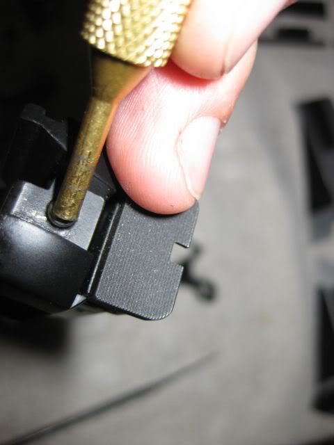

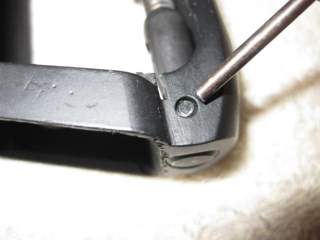

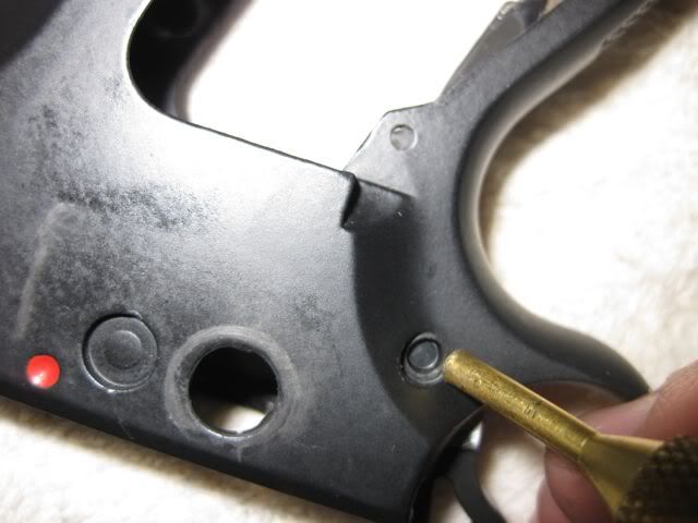

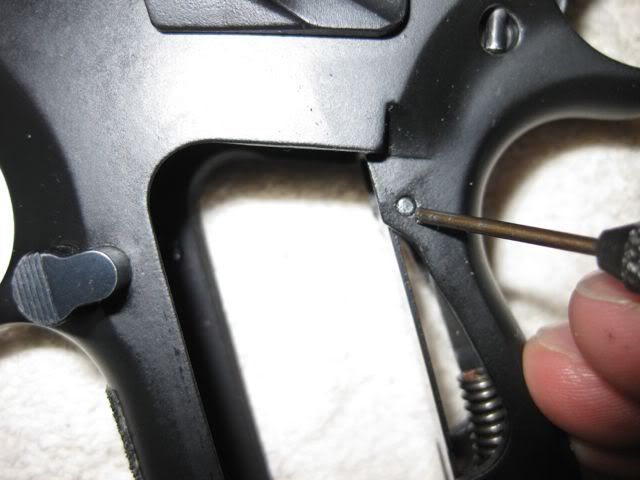

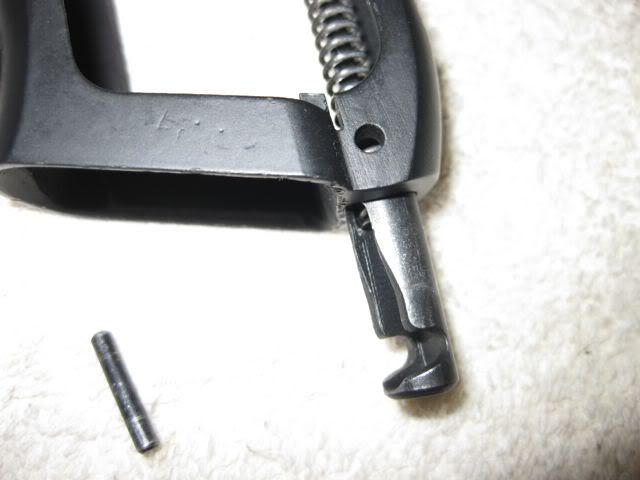

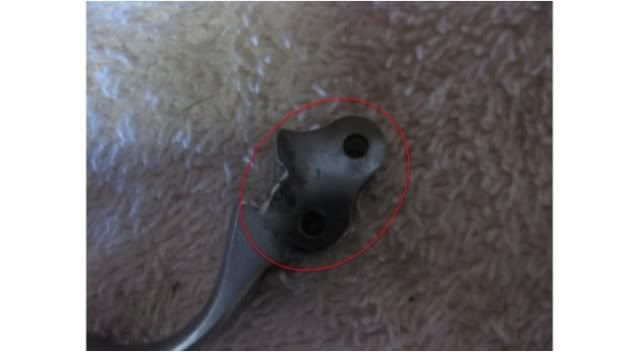

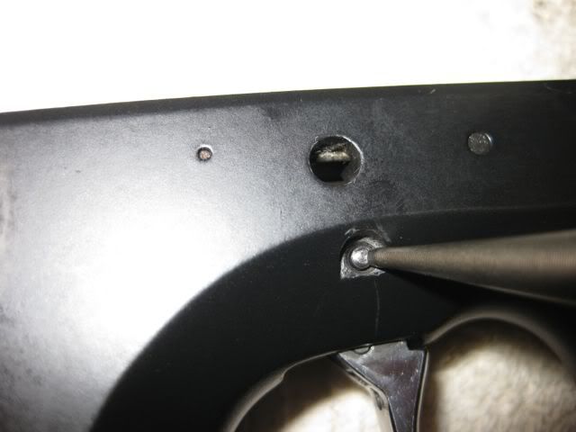

Remove the Trigger by beating the hell out of the pin with a 1/16th starter punch. I highly recommend replacing it with CGW floating pin. The pin will not be pretty when you get it removed so be sure you have an extra to replace it with just in case. Be sure to cover the trigger return spring with something to keep it from flying away when you back the punch out. I like to just turn the pistol upside down on the towel and place my finger behind the top of the magwell. The CGW pin is shown.
Back the trigger pin out to remove the trigger

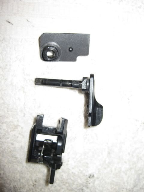

Remove the firing pin by depressing the firing pin in with a punch and sliding the plate off.  Slide the firing pin and spring out.
Disassemble the sear cage by pushing the pin out and separating the two parts. Remember not to let the spring get away from you.
This concludes disassembly.

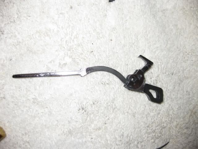

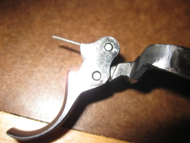

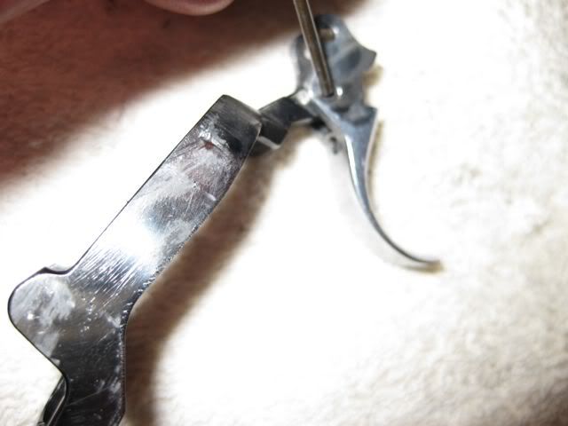

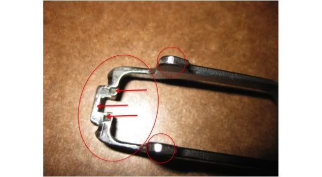

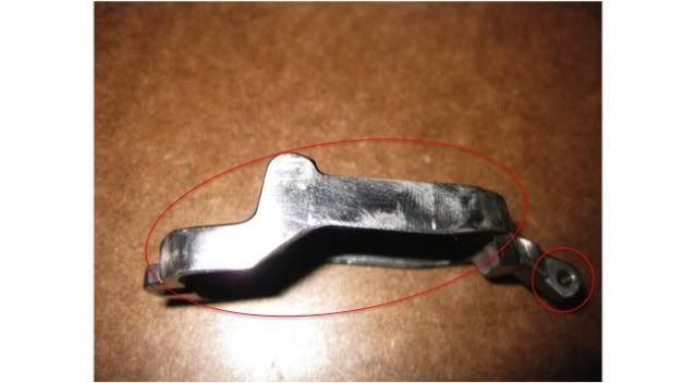

The first part to work is the trigger bar and trigger. Using sandpaper stuck to a glass plate begin working the sides of the trigger and trigger bar moving in increments from 400 through 1000 grit. There will be some deep machining marks left, but as long as it?s smooth it?s fine. Don?t? forget to polish the small area on the trigger bar that attaches the trigger.
Polish the bottom. Don?t forget the grooves.
Polish the top. You can rub the bulk of it on a glass plate or stones, the rest just attach some sand paper to a small file to get in the small areas. Don?t attempt to get rid of all the machine marks, particularly on the lower part. Remove just enough material to help the disconnector glide.
Smooth the two points where the ears of the disconnector engage. Again it won?t be perfect, but you want to remove the overall friction points.
Use the dremel with the feltbob and polish to finish buffing the triggerbar.

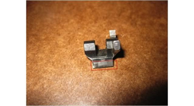

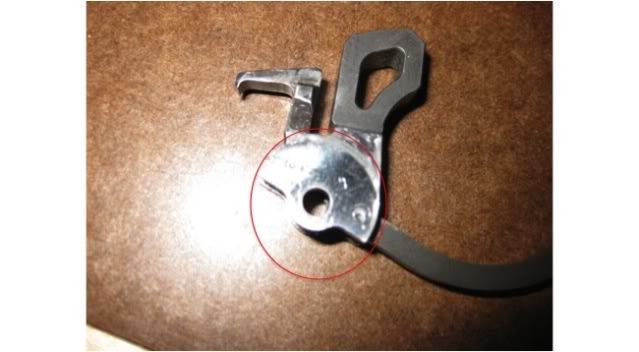

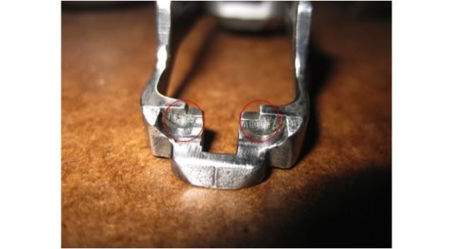

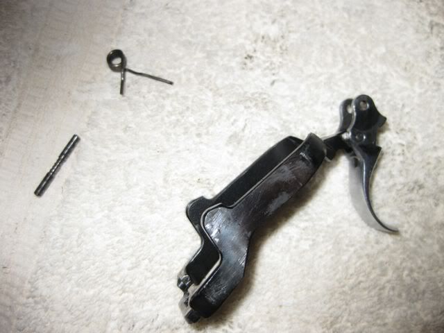

Smooth the sear cage and the sear. I used a ceramic stone set for this. Sandpaper would work fine also. I just trust the ceramic more with keeping the back of the sear flat.  I also smoothed the middle of the sear cage where the top of the disconnector touches.  Finish the sear cage with a light touch from the felt bob. I didn?t use the dremel on the sear since I want to make sure it?s absolutely flat with no rounded edges.
Polish the sides of the hammer making sure you stay clear of the hooks. Also polish and round the hammer strut to ensure the mainspring rides smoothly.  I also polished the hammer pin. Finish up with the dremel

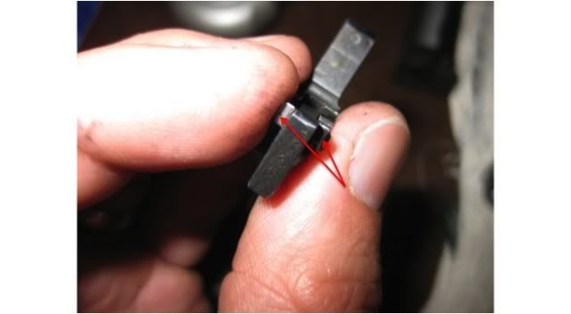

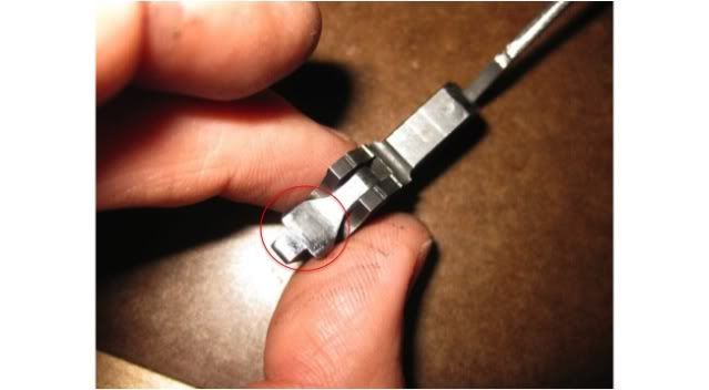

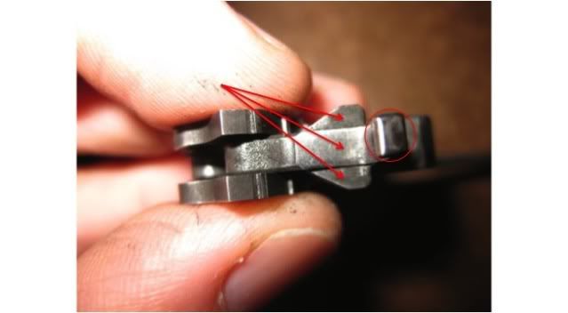

You can smooth and polish the disconnector without removing it from the hammer. Use a small file with sandpaper attached. Be careful to stay clear of the hammer and hooks.  Don?t take off too much material. You?re just trying to make it a little more slick.
Top of disconnector
Bottom of disconector, smooth the ears and the tip that drags along the frame as well
Finally lightly smooth the front of the ears. Just as before don?t take off too much material. Just try to knock down the high spots a little.

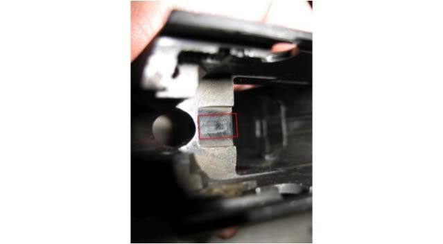

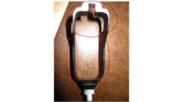

Lightly smooth the rear of the frame where the disconnector glides. Be careful not to round the edge. Take off just enough material to the point it feels smooth, don?t try to give it a mirror finish. I went up to 1000 grit, but didn?t remove the heavy machining marks.

I also lightly dremeled the firing pin with the felt bob and the inside of the frame where the trigger bar fits.  The intent is to knock off any burrs or rough spots, not to polish the areas. You can also do this with the hammer pin and trigger pin.

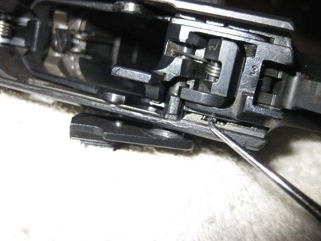

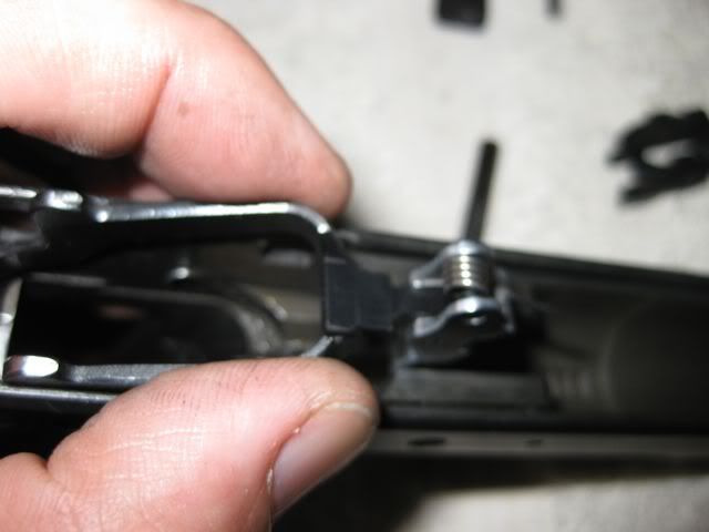

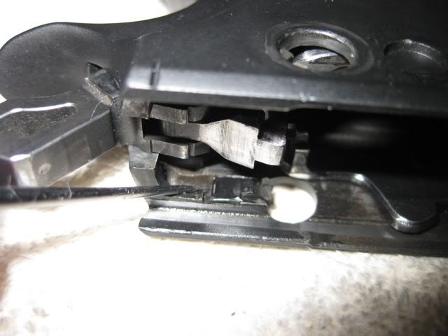

To reassemble just follow the reverse order.  Use the hammer pin retaining pin to act as a slave pin when inserting the trigger and trigger bar. It will hold the trigger return spring  in place. Insert the rear of the trigger bar first and then slip the trigger in.

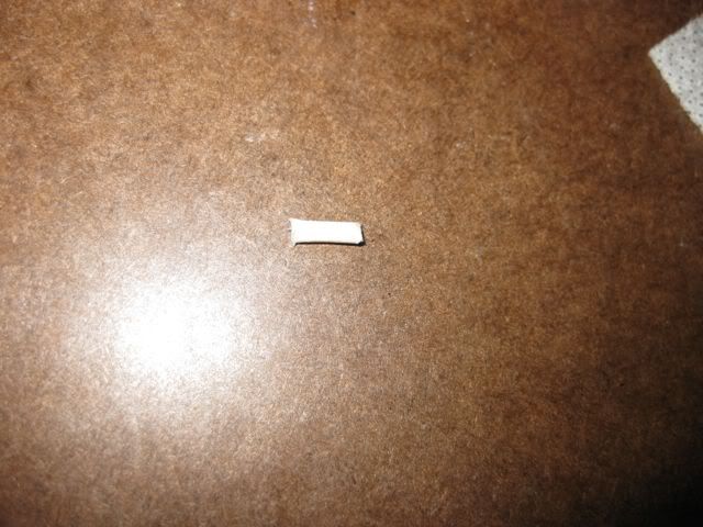

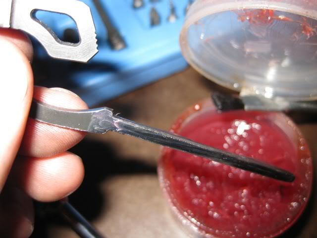

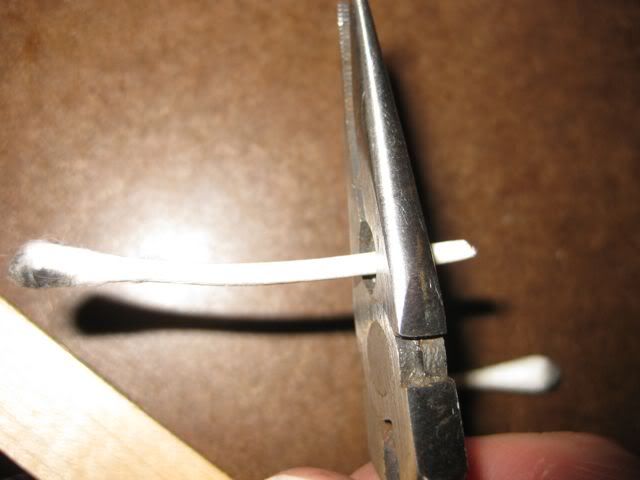

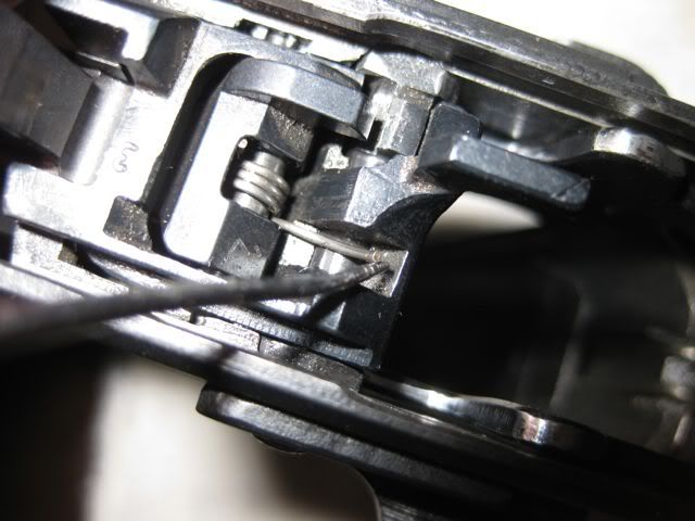

When assembling the sear cage I make a slave pin out of a cut q-tip and use it to hold the sear spring in place while inserting it into the cage.  The Main Spring pin and the Sear pin are similar in size. Be sure to use the longer pin in the sear.
Before inserting the Hammer assembly back in place put a light coat of grease on it. I like regular slide glide but any gun grease would work. It will help dampen the spring (you won?t feel the vibration in the grip when the hammer releases) and reduce friction during the DA Pull.

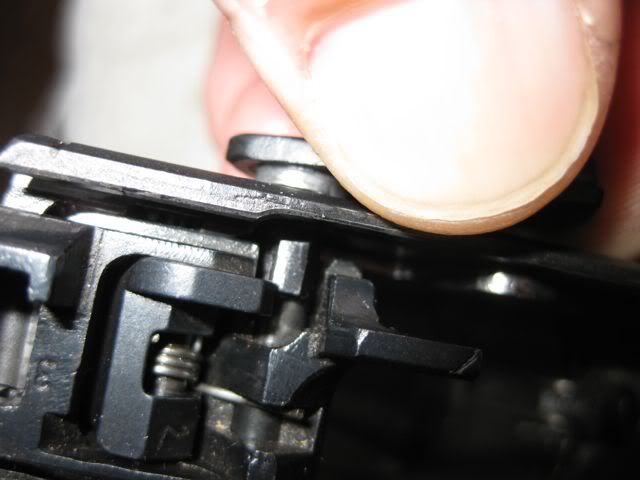

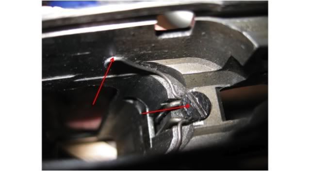

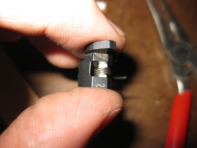

To insert the safety I place the right side in first. Then I work the left side in until it barely engages the right side. At this point use a dental pick to pull back on the left detent until the safety snaps in place. Then push the sear spring back into the channel on the safety. Forgetting to do this will cause it to come lose while shooting (ask me how I know).

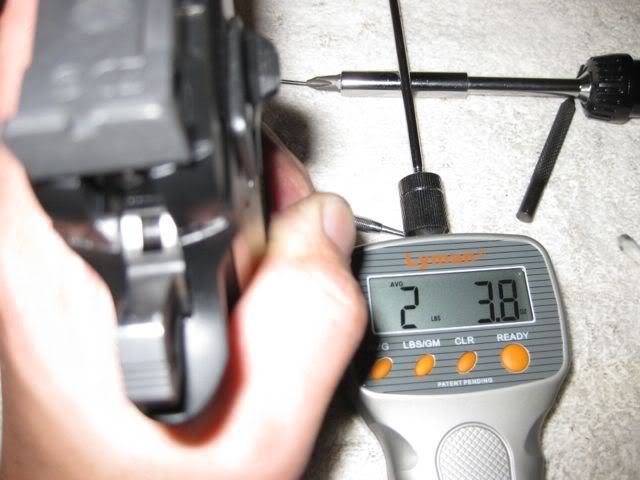

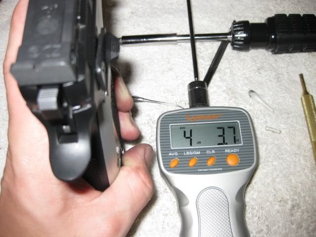

Tuning the springs for trigger pull:
The biggest factor in the DA pull is the mainspring. Cutting coils from the MS will reduce the pull weight, but it can also affect setting off primers. On 13# spring I cut off 4 coils and ended up with a 4#13oz pull that still set off federal primers. Main Springs can also be smoothed on the inside to reduce the friction on the hammer strut and turned down (thinned) to reduce the pull without having to cut coils.
To increase reliability you can tune the firing pin spring a little and add an extended firing pin. My firing pin spring was already tuned by CZ Custom and was significantly shorter.  I have the reduce spring from CGW, but haven?t tried it yet. It?s a much longer spring than the CZ Custom tuned spring.

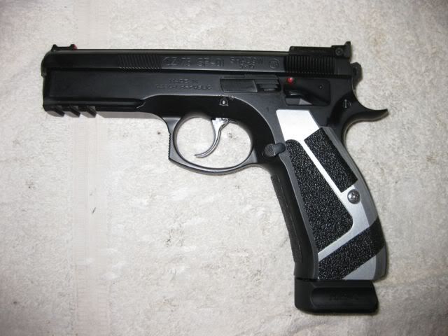

After installing Cajun Gun Works 8.5# spring my DA pull is around 4#3oz based on a 10 pull average. I made no modifications to this spring.

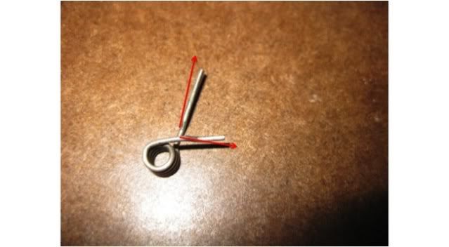

The trigger return spring has more of an affect on the SA Pull. By bending the legs further away you can reduce the tension. Bending too much will cause the trigger not to return. Be sure to keep the spring channels on the trigger bar lubricated with a lightened trigger. A drop of Rem oil works well.
DA pull
SA pull
