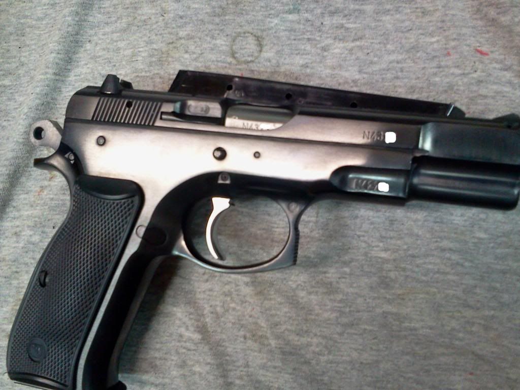

Not like either of those...
Not the best pics in the world
It came with some crappy Pachemyer grips on it, so I found the old plastic ones from my 75BD Police and threw them on there.
All of the stampings and numbers/marks on the gun are shown in the above pics.
The bluing is rather nice and although I'm sure it has seen a few rounds, it appears to have been shot very little... so far.   ;)

are you sure the date isnt 9"8"?
the slide says "B" and everything on it says "b" to me.  the only exception is the frame where it has "Czech made".  i dont remember seeing anything like that or partially that format.   And the frame is "b" too.
it appears you have a frankenstien CZ???.  the slide has N48xx and the frame has N43xx ???  the s/n on the bbl looks like N43xx.
to me, the lettering on the left side looks/appears shallow.  i would say/guess (just looking @ the pics tho) that its been refinished.  maybe the lower more so or had more material removed to the point where the "czech made" was stamped into the frame.
should be interesting to see what others chime in with.
fwiw, i would take it for a test drive and see how it prints.   if its shoots great, then i would keep it even if it is a put togeather gun.

The serial numbers all match. It hasn't been refinished. It is stamped 93 in the usual spot near the ejection port.
From here: http://www.czfirearms.us/index.php?topic=14699.0
"Transitional" models require some explanation as well. In a strict chronological order, these preceded the Type B, but I thought it would be clearer to discuss this last. Essentially, these are handguns produced with a Type A slide on what appears to be a Type B frame. A "transitional" does not have a Type B frame in the strictest sense, since it lacks the firing pin block lever (part no. 14 in current CZ manuals). In other words, these models have a square trigger guard and rounded hammer like a Type B, but they have the slide and external controls of a Type A. Some CZF members have also found versions with the modernized external controls associated with the Type B. (Official CZ-UB photos of the CZ 75B prototype actually depict a true Type B with the spur hammer in place of the rounded style, so I am now officially confused.) "Transitional" models were produced in 1993 and 1994. There are also transitional CZ 85s, but identification gets very complicated, as the 85 Lux and 85 Combat models were the basis of the Type B pistols. Transitional pistols are comparatively rare (due to the short time they were produced), but Magnum Research and Action Arms imported these models in some quantity, so they are not particularly rare in the U.S.
It is definitely a B model, but I'm beginning to think this may be a "made for Europe" production pistol that was brought over to the USA sometime in the last 19 years.
