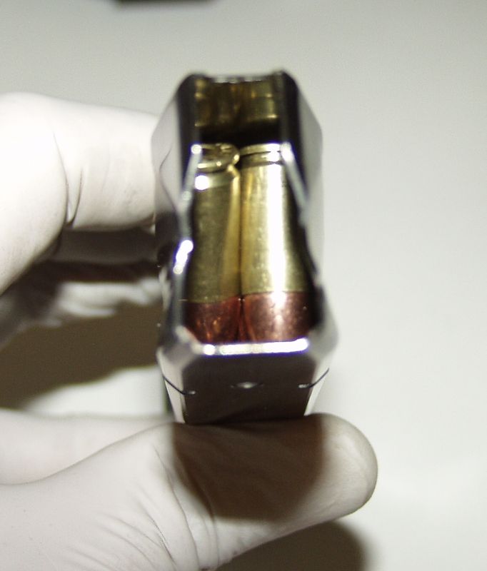

Hi, All...
I have a dilemma that some perhaps have seen, perhaps not.  I've inserted an image of what has happened to me while running a few stages and am trying to understand why.  While shooting I will have to insert a fresh mag because all the rounds on top of this failure mode will simply not have spring pressure to advance the rounds up the magazine tube.  All rounds above the wedged rounds simply go limp and fall out of the magazine.  Of course it takes a second or two to realize that the magazine has failed to feed, all costing time.  This same failure has occurred in both the 20 round mags and 26 round mags.  The 26 rounders have been upgraded with rectangular springs and abbreviated cam follower, while the twenty rounders are CZ factory spec.  The failure mode has occurred more than once in either mag capacity.  Magazines are super clean, no dirt, dust or sand.
Thanks!
Has anyone else experienced this?
Greg T
Tried to add image but regardless of method -- could not attach directly, sorry.  Please follow link below.
http://s393.photobucket.com/user/ThomasDesigns_bucket/media/Blasters/Small01.jpg.html?sort=3&o=0

Greg,  just right click your pic and copy the URL.
Click the mona lisa icon above and post your pic's URL in between the brackets.
With both mags doing it and clean,  I don't have a clue.  My very first thought would be weak springs, but those rounds shouldn't be able to pass side-by-side like your pic is showing. :-\

usually on big sticks, when stuffing the mags to capacity, if the mag is slightly wide in tolerance you can squeeze the rounds enough that the will get side by side ( especially with 9mm, because of the tapered case )  instead of staying staggered.
when they feed up, the rounds will bind in the tube.
as an experiment. take the mags that do this. load one to two rounds down. bet it doesnt do it?
how to fix. you can try and put tube in a vise and give just a nice light hug to tighten up the tolerance.

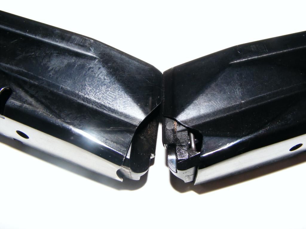

  9mm Tactical Sport-  follower will catch on the side of the mag if it is compressed lower then the ribs on the bottom of the mag.
  The ribs on the TS 9mm mags will catch on the cartridge and or follower.

BTW: The pic of the wedged rounds is actually the way it failed at the range, it still has the cam follower spring pressure in the mag.  Photoed when arriving home.

All my 20 rounders are CZ factory, no changes.  The big sticks, which tend to fail more than the 20's, not just for the problem noted here and don't know where to start, other than what I'm showing.  Each big stick has the CZ Custom guts in it which allows (Most of the time.) pretty reliable feeding.  But I have had the cam follower roll over inside the magazine more than a few times.  That is easy to understand, though.

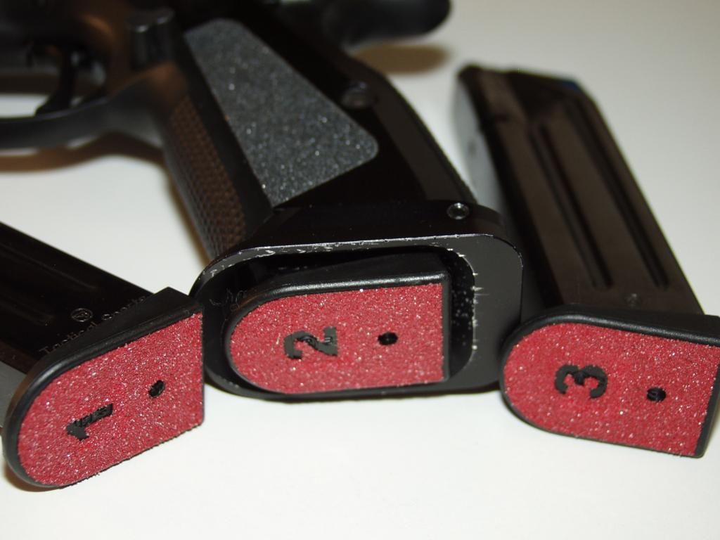

All the mags are marked:
On the big stick mags they do exactly as you describe, the rounds will periodically bind.  No binding with 1-2 rounds.  So, I put one of the big sticks in a machinest's pin vise, nice parallel jaws, which captures about 4 inches of the mag tube.  (Mags disassembled.)  I squeezed the mag body by .005 total, making the body .861.   Checked the fit in the gun and had slight binding on the front and back walls when inserting the mag body, so a slight squeeze on the front and rear walls solved the fit-up.  Unfortunatly, the cam follower no longer rises to the top.  It stays about .060 low and does not operate the slide catch, plus the top last round is a little bit floppy in the mag.  I'm thinking .005 might have been to much.  I'll keep working with it.
