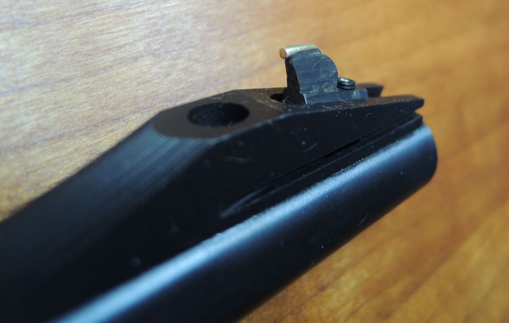

Not knowing when I might get the #2 and #3 sight posts from CZ I decided to modify my #1 post.  Using the sight correction from the Brownells calculator I figured something around a 1/16" would be close.  I tapered the post a bit and put a shallow groove in the top to center a little brass brad which I then soldered in place. The back end of the brad I cut off about a 32nd out from the back side of the post and faired the front to the profile of the post.  A bit of fairing on the sides and now I have a little brass dot about 3/64th in diameter to center in the J&P peep site.
Probably more by luck than design it is just the right height to zero at 50 yards with the tangent sight set at 50 and the front post about 2/3 the up the ramp.  That's using CCI Mini-Mags.

Nice modification.  Got any pics of the finished product?

I'd like to see it too.

« Reply #13 on: January 23, 2016, 01:18:31 PM »
Here it is.

« Reply #14 on: January 23, 2016, 01:30:12 PM »
That looks good.
