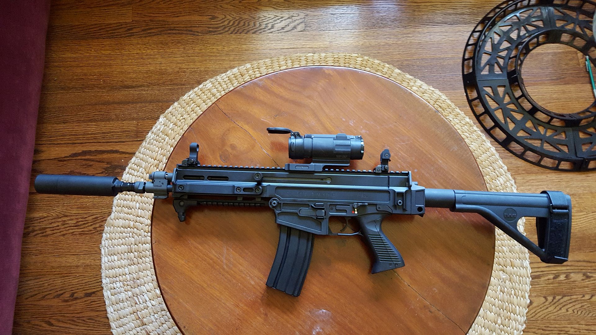

I found a barrel "extension" that could work from CNC Warrior, 14x1 at 4" long. That with a 1" 14x1 to 1/2x28 adapter, makes the Bren a regular sized carbine. This would work well with a muzzle brake but will start looking like flagpole with a suppressor. I put on the suppressor with the adapter and cheek brace and it is now a fairly long firearm.

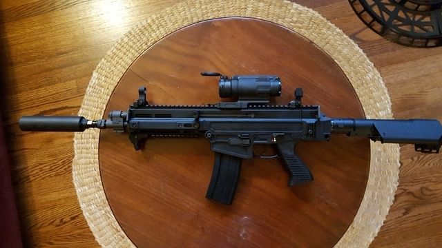

While waiting for the barrel extensions, trying out stabilizing braces. This is the newer ACE Galil SB that is almost a stock.....looks like one anyway. The Comp M4 may have to go as this firearm needs some weight loss.....maybe a smaller red dot would work better.

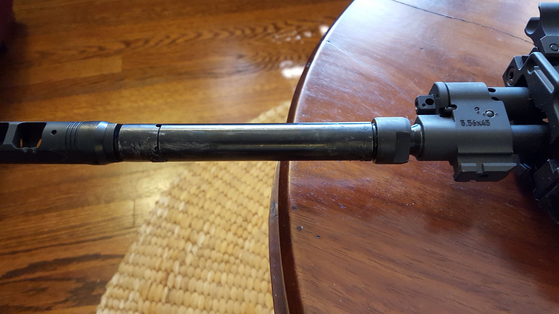

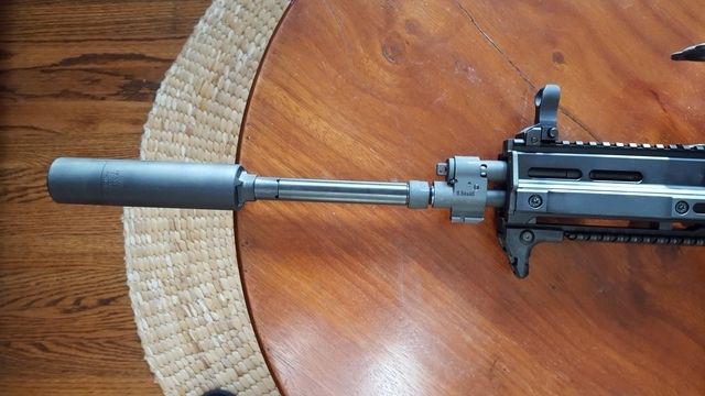

Ok, extension/ adapter is here. My intent is to pin and weld the end where the extension screws into the barrel and weld one or two of the detent holes between the extension and the adapter. Am waiting for the welding machine and would like comments, suggestions in the meantime. The length is not as long as I imagined. It is over 5" but looks good. i've seen someone do this on a video (Cool blind fellow who fires a "carbinized" Bren).  Here's a pic.

Here it is. Not at all pretty but it should work. I still need to do additional re-bluing on the extender but its is pinned, welded and "carbinized."
