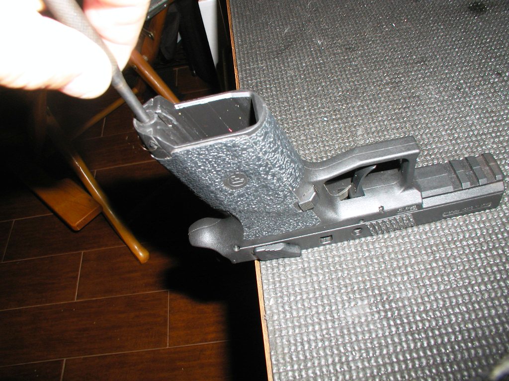

I don't have the drawing before me, but I am guessing that is the plug behind the base of the magazine. The one that holds the spring that has been making it a real challenge for me. Not a single video I have used has referenced this. But it makes sense.
I use a pin punch to push it down with the hammer in the up position, while pushing the pin out with a small punch.  Put your body against the back of the gun to stabilize it.
