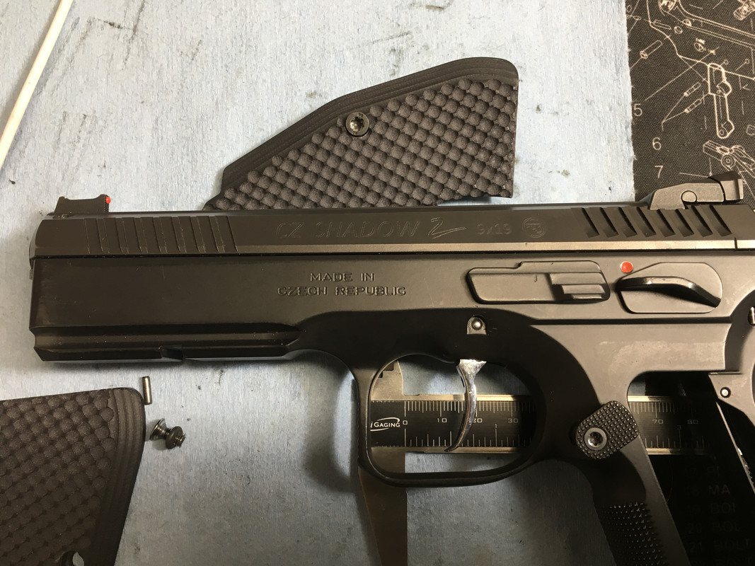

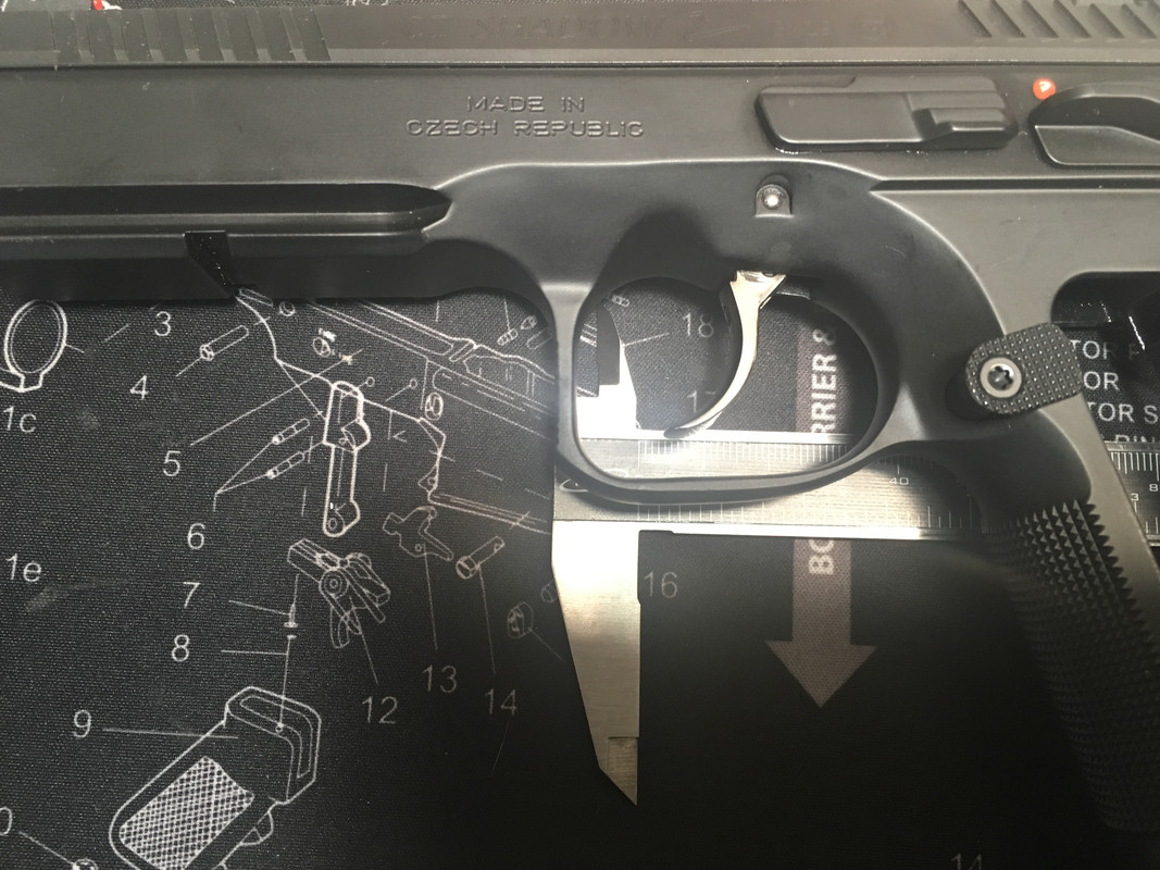

Has anyone here ever been able to bend a standard 75B trigger so it doesn't have as sharp of a curve in its trigger bow? I know CZ custom and Cajun gunworks have aftermarket replacement triggers, but I figured I'd ask here before spending money on triggers.
I was very close to completing mine when I needed a small adjustment to clear everything and I fubared the project. If I ever get another trigger to try, I'll remember that error!
I had blued it and thought I nailed it, but again, the small adjustment was fatal.
Sent from my SM-G973U using Tapatalk
What’s wrong with the trigger in the picture?

« Reply #7 on: June 19, 2020, 08:20:13 PM »
I took that picture before I did the last adjustment and at that point it all went to crap. Kicked myself in the butt because I knew better.

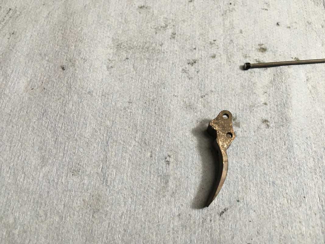

  • Posts: 3799
Re: Bending a standard 75B trigger
« Reply #8 on: June 19, 2020, 08:24:34 PM »
for people here to learn not to do what you did, it would help to see how it went wrong.

Great point. I'll explain.
Before I started, I used my dial caliper to measure the radius of the trigger sweep using the stock trigger. I then began heating, straightening and checking angles between pivot hole, trigger bar hole, and length. I tried the trigger in the gun a few times. I needed to either change the angle forward a few degrees or shorten the trigger by bending the bottom or just shorten it overall. I decided to change the angle. I put it in my vise and forgot to add support to the pin holes. I heated, attempted the angle change, and the pin holes collapsed. It was junk at that point.
It will work done properly. It felt great in the gun. I was happy with the triggers I changed for my CZ guns prior to this experiment, I just wanted to see if I could do it as I love the flat Geissele SSA in my one AR.
I did not take pictures of the destroyed trigger nor did I save it.
