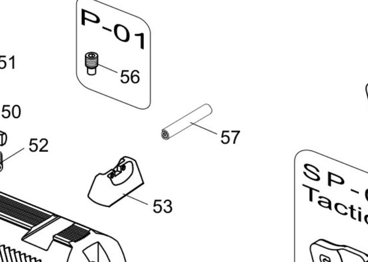

Thanks for the comments. That pin pictured above looks thin. I'm wondering if that's a coiled pin or is it actually two roll pins one inside the other? Because I noticed in the latest CZ 75 Manual diagram they're not showing two roll pins anymore like they showed in previous manuals (2mm roll pin inside a 3mm roll pin.) Now they're showing one coiled pin and not sure how long they've been doing so:
The description for part 57 is "Firing Pin Coiled Pin".  (In previous manuals, it was called "Firing Pin Roll Pin 03"  and "Firing Pin Roll Pin 02".
