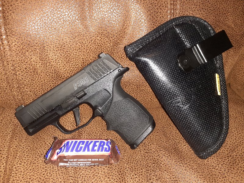

Besides raising the bar forever in terms of high capacity in a micro-9 size....I have to say I've really been enjoying the SIG P365's flexibility.
The shorter SIG P-365 and longer P-365XL Optic-ready slide can be used on either frame. You can come up with some interesting combinations. FrankenSig!  O0
Thought I'd share these images of an SAS Slide with the new FT Bullseye Fiber-tritium sights that I purchased separately from SIG parts on the XL frame. This slide does NOT have the cutouts and can be used with the standard 365 barrel and spring set (also available through SIG parts). 12+1 9mm in this micro size is amazing!
Also pictured is the XL slide with the new Romeo Zero RDS.
Although the P365 (now with >4000) rounds has been 100% reliable with any type of ammo; I was reluctant to pocket-carry until I discovered these excellent Kydex Pocket holsters offered by Vedder or Alabama Holster that completely cover the trigger guards and have a thumb tab to assist release and easy draw.
For 10 round limited States of course the regular 10+1 frame will take 10 round mags (or 12 or even the 15 round mags where legal) but the XL won't take the short 10 rounders.
Meanwhile.....I just sent my standard P365 slide to Fabricated Arms to mill for a new Holosun 407K micro red dot. The Romeo Zero is OK, but I think the Holosun mounted on the short slide using the X-Ray 3 sights as my BUIS will be even better.  8)  -Vinny

Vinny, that is pretty good combination.
P365SAS slide on P365XL frame would be a great addition to P365 family.
I love SIG's flat trigger.
Is this regarding SAS slide on XL frame?

4100 so far on original X-Ray-3 slide (which just went for milling and patina cerakote). The SAS slide with the flat FT sights is brand new. This is a special slide available through SIG Parts (under slides) that is made without the slide cuts for ported barrel; so the standard barrel/recoil assembly from a regular P365 can be used.
Our range is currently closed so I've only been able to practice draw/present/and dry fire with the new slide. Really though, it's the same two-eyes-open on target presentation as a RDS for fast defensive shooting, not bulls-eye accuracy though.
Anyhow, I agree the XL's flat trigger and full grip is nice!
