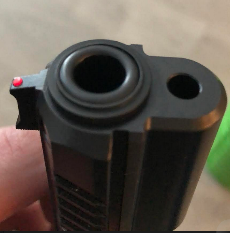

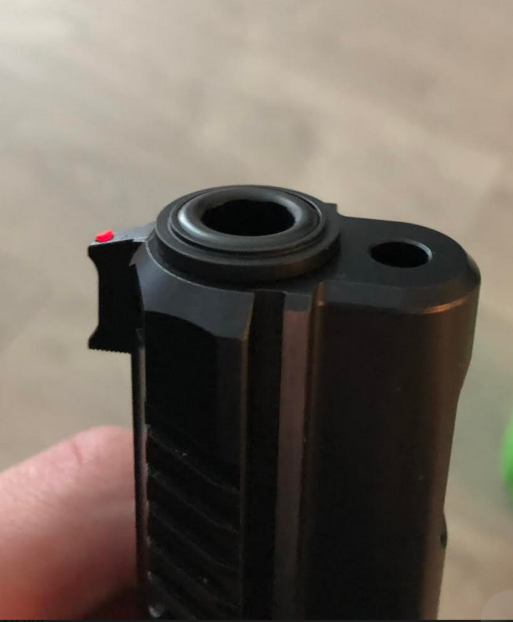

Hello,
I recently purchased 10x barrel bushing for my shadow 2 and managed to install it without problems. However when I now try to assemble the gun, I no longer can fit the barrel in the slide. As shown in some tutorial videos, I gave it a few very light taps due to it being so tight and it drops in but refuses to move forward at all inside the slide and past the bushing. The barrel can still be removed with relative ease from the slide.
 I will attach a couple pictures I took to try and show the situation a bit better.

Will the barrel move into the bushing if you stick the muzzle end into the bushing from the front of the slide? I'm wondering if you caused any distortion upon installing the bushing? Also did you line up the notch in the bushing so the sight pin slides in as it should?

« Reply #9 on: January 22, 2022, 02:37:49 AM »
It does not fit from the front. I was thinking about the dostortion as well, but how would this happen? I lined up the notch and it went perfectly on the first try,  tested it with punch before instaling the pin. It went in quite easily as well. What you imagine could have caused the distortion?

Here are the pictures showing how far the barrel is able to go

« Reply #13 on: January 22, 2022, 06:09:26 AM »
I would measure barrel O.D and bushing I.D.
Contact CGW with the measurements. Guessing the bushing is out of spec.

« Reply #14 on: January 22, 2022, 06:39:51 AM »
I agree and CGW does also show different size bushings for the regular guns vs the Shadow so I wonder if he either ordered the wrong one or was mistakenly sent the wrong one.
