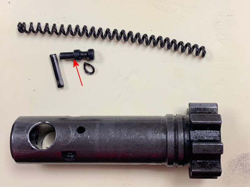

I took my 11" Bren2 Ms out again today and put 90rds through it.  Ejection is weird.  Half of the spent cases go to about 12:30 and the other half go to about 2:30.  There was one stovepipe on a spent case where the following cartridge fed into the chamber.  My guess is that the spent case hit off the rear of the ejection port, bounced forward and was caught by the bolt carrier going forward.  This is so frustrating because the ergonomics and light weight of this rifle make it feel great in my hands.
I removed the ejector.  Its channel appears clean.  The only oddity that I found was a little ring that was around the part that the arrow points to.  I can't really tell if it's metal or rubber.
« Last Edit: November 30, 2022, 06:19:01 PM by Bret »
That is indeed odd — there is no “O” ring or anything similar shown with the ejector on the official Bren 2 parts schematic. I don’t recall seeing one on the couple of spare ejectors I’ve been able to (sporadically) acquire from the CZ USA Webstore.
Does it eject / cycle better without the O ring?
« Last Edit: November 28, 2022, 07:50:37 AM by MeatAxe »

It's still taken apart, so I don't know.  I can't figure out why they made the spring so long.

That little circular piece sticks to a magnet, so it’s steel. I think it’s the end of the spring that broke off.
