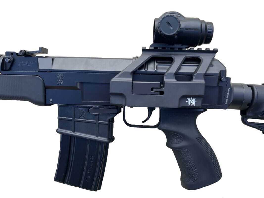

The side rail that CSA offers states that it will allow the use of AK side mounts, although it does also say that most will put optics too far forward.  I measured based on pictures and the orientation of where the securing screws go on the Vz.58 receiver, and it looks like the Midwest Industries ACOG mounts will almost certainly not interfere with ejection or loading from charging strips.
OK folks  -I want to PUBLICALLY thank AR Tenner for SCHOOLING ME!  He IS CORRECT.  I just took my Midwest Industries AK rail - full length - and it locks in solid on my VZ 58.  I had NO idea.  I like the MI rails in that they can lock in from the side on an Ak rail.  On the VZ adapter you have to start a little further back, but you can STILL get it on even with the side sling mount adapter I use.
One thing I've noticed is that you CAN use the irons UNDER the the MI AK rail - at least the picatinny one, and while its not great, it is doable.
So.. now I have to get a REAR BIASED MI rail
I believe either the rear ACOG or Pic rail is fine.  THE ONE drawback to MI is that they will be a bit HIGH, but with my straight SIG MPX stock, I think it is fine, just playing around with a PA SLX MD 20 on the pic rail.  Of course I have to get on ethat is rear biased.  IF Master mount makes one FOR the VZ 58, I'd get that LONG before RS Regulate decides to make them again.

For now I will go with the MI mount.  It is a tad higher, but if you mount the optic with no risers, it works.  Lock up is very good, and the best part is that it goes on without having to start so far in the rear.  I am using a left folding stock AND a sling mount and have little room - but the MI mount still clips on - and is plenty robust.  Also, it fits now fine.  If I switched up the stock, I'd probably use the Master Mount.   I think RS Regulate is no longer in the VZ 58 market.

Report on the rear biased MI rail...
It doesn't really fit well.  I thought it was because my VZ 58 CSA rail, BUT the Gen 1 full rail from MI fits VERY well, and I tried the rear biased rail on an AK and it has similar issues.  So.. I surmise that its a defective product and it will go back.  OR, the Gen 2 Rails fit differently - but i doubt it.  Very disappointed because the Gen 1 works SO well, and it fits on from the SIDE as all MI rails do, so you can have any funky thing hanging on the back as a stock and still use it.  I may order another.

I am now waiting on the Mastermount VZ 58 model.  Why?  I figure that with that ONE mount, I can get a micro prism to sit as low as possible, or put an MD25 on it - it has picatinny and ACOG all in one.
