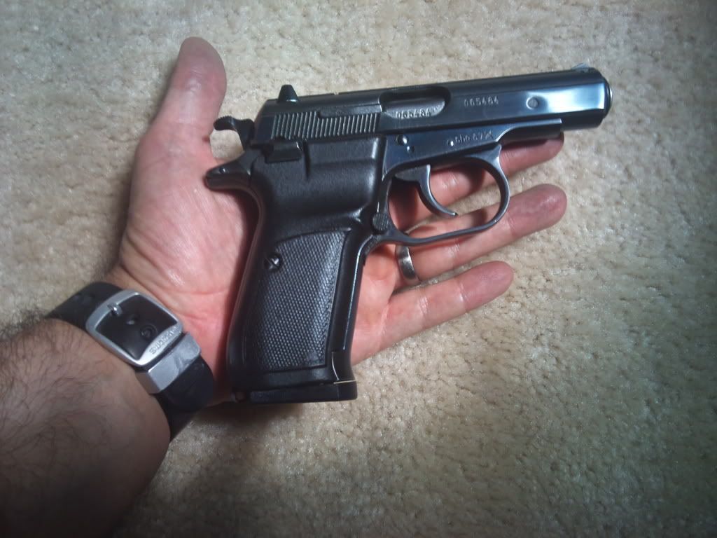

« Reply #73 on: January 04, 2011, 02:11:01 PM »
And, the long awaited pictures...as you can see, the finish is rough, but the gun looks just fine.  Going shopping for ammo, today.  :)
