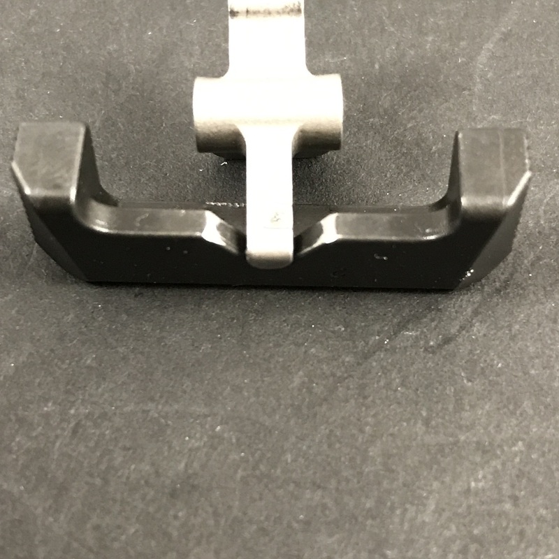

So I noticed that the P-10C mag release button is pretty hard to activate without adjusting your grip.  It's quite rough feeling when pressed too.  I studied the parts and found where I could smooth it out.
The catch itself is already pretty smooth.  Still, I polished the circled area with a dremel, a felt wheel, and some Mother's Mag & Aluminum Polish.
On the release button, the upper sections of the "V" slides along the bottom of the mag catch as it's pressed.  Mine had a very rough edge on both sides.
The "V" is 90 degrees, so I used a Brownells X-Fine Ceramic stone to clean up the edges.  I slide the release button back and forth a dozen or so times.
Below you can see the spots that got smoothed by the ceramic stone.
Now the release is smooth and much easier to activate.  I can release the mag without shifting my thumb now.

I recently picked up a P10C with the mag release issue and tried all the polishing and stoning before finding this particular thread. I also noticed that my mag would move up slightly as I depressed the mag release and now, after leveling the top end of the mag catch, my mag release now works very smoothly. Just an FYI that this did indeed work for my particular findings.

The polishing is all well and good but it does nothing to address the real problem. If you've ever had a CZ75 you know about the mag brake. The tail of the P10C mag release (the part highlighted in red above that makes contact with the mag) actually acts as a mag brake. I removed minimal amounts of material several times until I got the mag to fall free. On a 75 you can take out the mag break and the mag will fall free, but it will also be very loose in the gun. I suspect if you took that tail completely off the P10C mag release the same thing would be true. As I removed material I put a gentle curved radius in the piece that touches the mag. Mags fall out like all my other guns now.

GLN305's re-profiling of the mag catch makes things work the way they should have when the gun left the factory. THANK YOU !

I would think there's a reason CZ made that piece with an angle. After some wear, it wouldn't surprise me if you start seeing some unintentional mag drops under recoil or inadvertently touching the mag release.
I'm not saying it will happen but maybe something to watch out for.

It's a matter of less than 0.010 - not worried. It's just. a matter of tolerance discrepancies.
