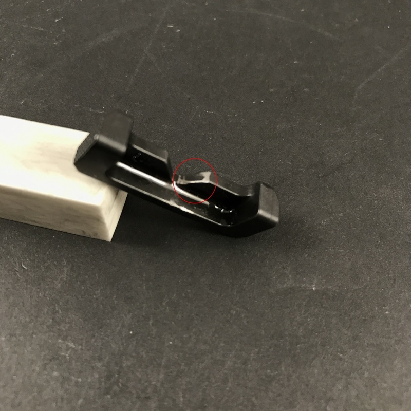

The catch itself is already pretty smooth.  Still, I polished the circled area with a dremel, a felt wheel, and some Mother's Mag & Aluminum Polish.

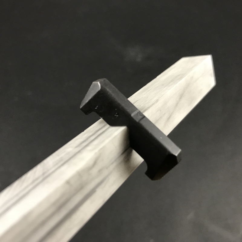

On the release button, the upper sections of the "V" slides along the bottom of the mag catch as it's pressed.  Mine had a very rough edge on both sides.
The "V" is 90 degrees, so I used a Brownells X-Fine Ceramic stone to clean up the edges.  I slide the release button back and forth a dozen or so times.
Below you can see the spots that got smoothed by the ceramic stone.
Now the release is smooth and much easier to activate.  I can release the mag without shifting my thumb now.

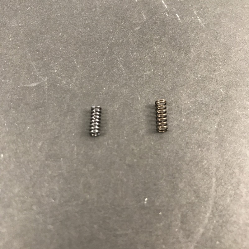

So I was talking back and forth with rich63 and I decided to see if I had any other springs that could lighten up the mag release button.
Left: P-10C mag release spring    Right: Glock 19 factory firing pin safety spring
The Glock spring fits perfectly and really drops the mag release button effort, similar to my M&P .22.  It feels good with an empty mag but it's almost too light with no mag or the mag loaded and the slide locked back.  Without the follower pushing against the slide release, there's no extra resistance from the mag and I'm afraid I might accidentally release it while shooting or completing a reload.  I'm going to leave it in though and see what happens at my pistol class this weekend.
https://www.youtube.com/watch?v=5xQcA4F2USs
Update:
Well the Glock spring made the button easier to press.  Too easy.  Twice I accidentally pressed it with my support hand palm while shooting during the class.  Admittedly, it was during 10 shot rapid fire strings where I got lazy with my grip.  Probably fine for competition only, but I put the factory spring back in during a lunch break and didn't have any issues since.

Just got back from my class.  The magazine is harder to release when the slide is closed because the mag spring is pushing against the bottom of the slide.  When you press the mag button slowly, you can actually see the magazine raise into the frame a tiny bit before it releases.  When the slide is back and there are rounds in the mag, there is zero spring pressure and the mag button is easier to press.  With the lighter Glock striker safety installed, it was too light.  I had the mag drop out twice during speed shooting drills.  Two other shooters dropped the mag while firing too.  The factory spring is going back in.
