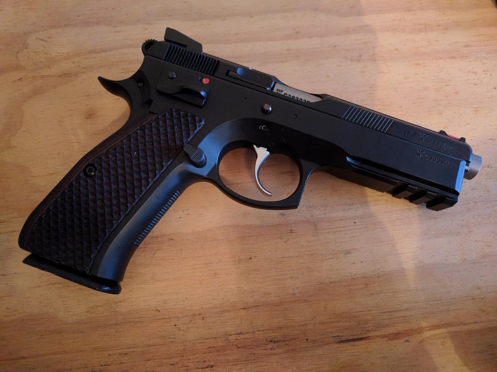

« Reply #35 on: June 13, 2019, 04:53:44 PM »
Well, there's a minor miracle....it's alive lol
Minus the alleged disco, naturally  ::) but in my hands, finally

« Reply #36 on: June 13, 2019, 06:15:01 PM »
It's been so long, if you still remember how, you can remove the barrel and use that as the judge for some of the ammo tests we discussed.
Congrats on the pistol's return to home.
