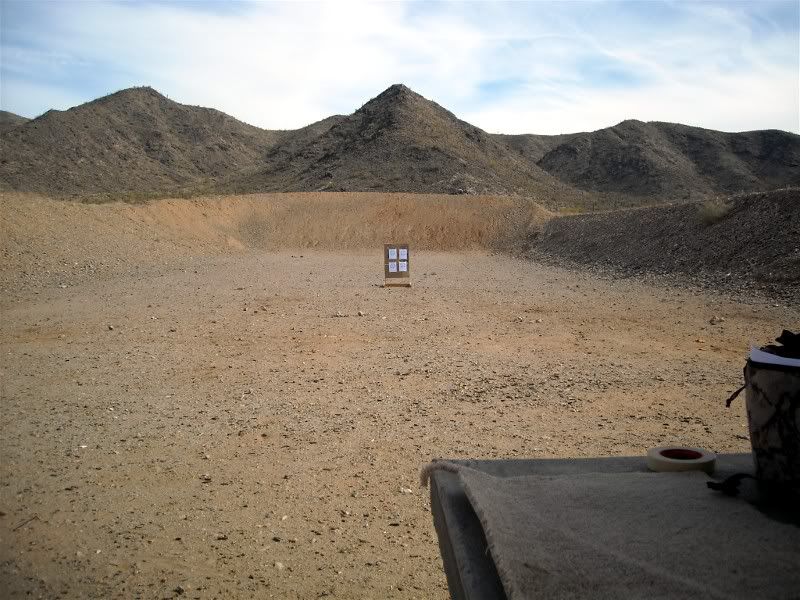

Is it me, or does that look kinda far away?

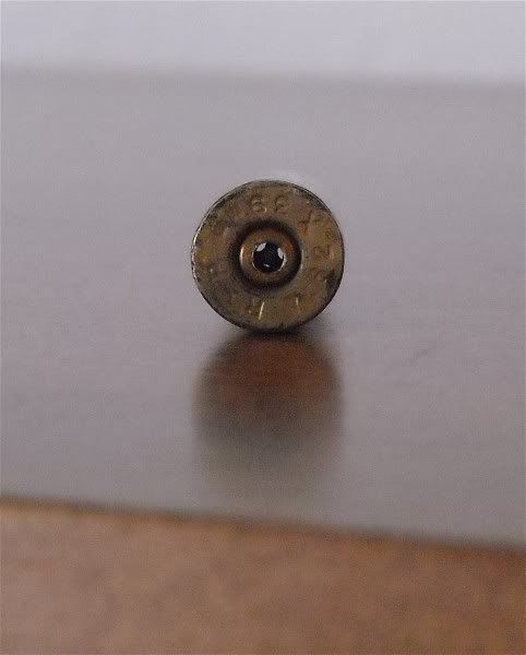

All well and good, except for one WEIRD stoppage. Two Failures to Fire with light primer strikes made me look very closely at the reciever, figuring my unscientific dirt test had finally clogged the firing pin channel. Nope, it was good, but the bolt wasn't going all the way forward, actually stopping just out of battery! What the heck? So I worked the bolt, which quickly began going back into battery, when I noticed a tiny shiny disc of brass, bent over in a corner in the reciever. Say huh? I pried it out, and all was well. it wasn't until later I found out WHERE that bit o' brass came from...
That will get your attention! Very old Remington brass, good WSR Primers, standard load of 24grains Accurate Arms #1680 at 2.17 under a 123 Hornady FMJ. I am wondering if old brass with a worn primer pocket had let the primer expand to the point of losing that disc of brass? In any case, that case is now in the recycle can. 5 years I got out of that one. :)

Good narrative and photos armoredman, almost like being there myself (up to and including the requisite range fools ;D).
That 25yd target does look kinda far away, but I've found that things I'm shooting at often do. ;)
